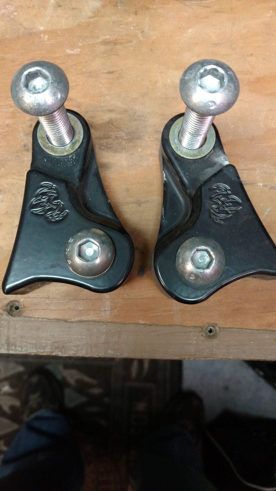

If you have HD premium hand adjustable shocks, I have a Tamarack lowering blocks for sale. They worked good for me.
Cozz
