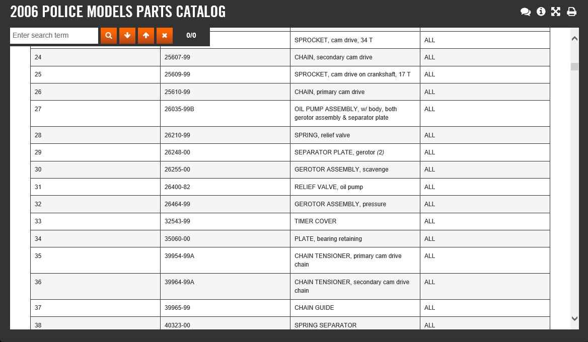

Yes, i know there is a massive thread on this topic. The question i have is regarding the 2006 Police setup.
I've read in a few comments here and there (Not on this page) that the 06 might have a hydrolic tensioners. I also read the giant write up on this forum. Great write up with tons of great info.
Can anyone confirm or deny that the 06 does not or does have hydrolic tensioners. Are the engines the same in the FLHTPI models compared to a standard Harley electra glide with the 88cc?
Just trying to prepare and save up for a SS 510 gear upgrade. My bike currently has 8800 miles. So still a virgin.
Thanks in advance gentleman

06 Dyna models came with hydraulic tensioners, other models in 07.

Take a look at items #35 & 36 … not hydraulic tensioners

Thanks Rags and Guinea
