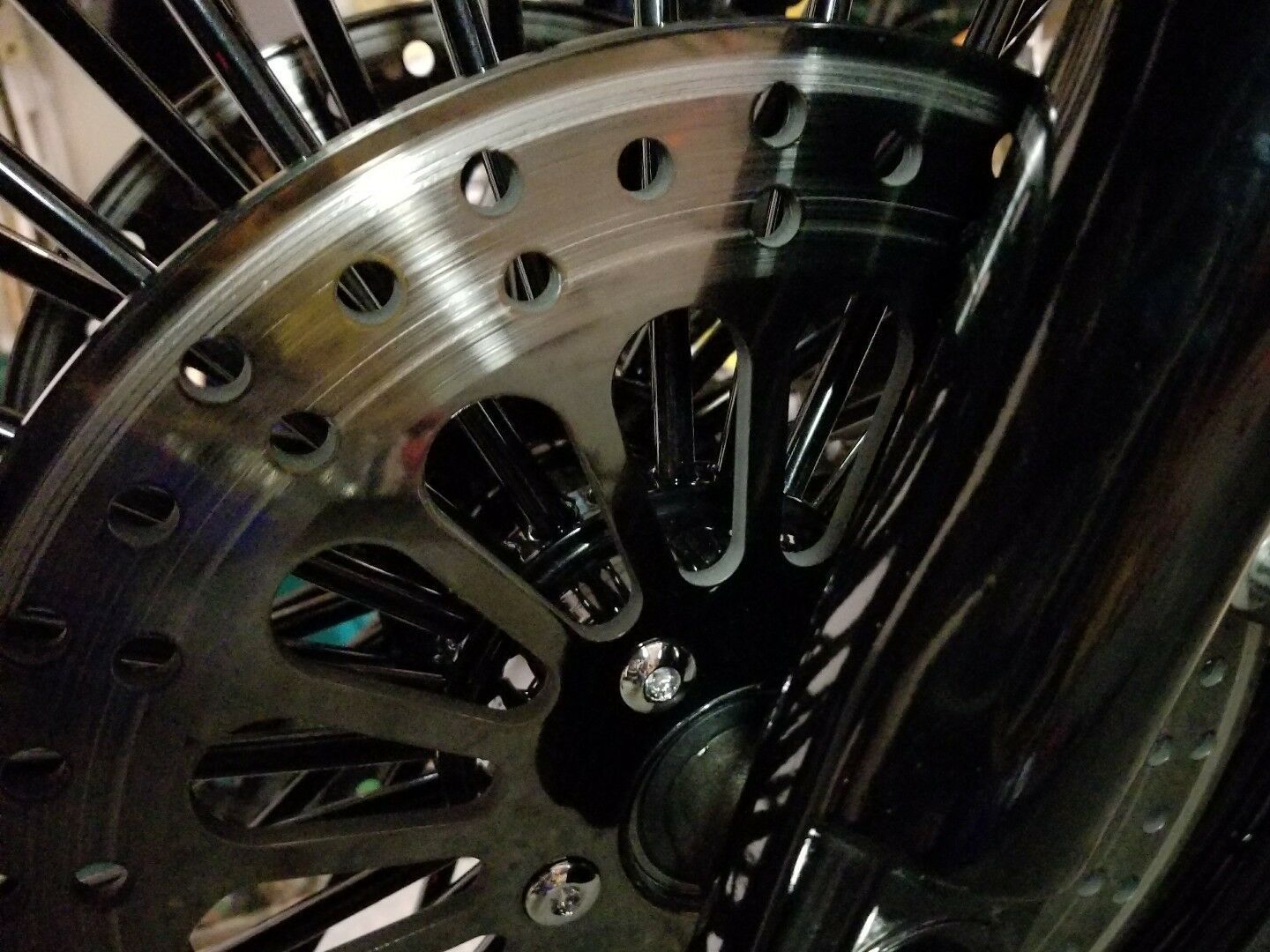

Originally Posted by miketv84
Brand new pads and rotors on an 07 Touring. Went down the street and had this happen to one side. I don't know what to make of it. Seen it on older rotors and pads but never instant. The rotor still looks ok.
`Looks like some speck of something got under the pad at the outer portion, There is some pretty heavy scoring there, and that rotor doesn`t look good to me.
Originally Posted by RANGER73
Looking at the picture of the pad, there was a chunk of something EMBEDDED the pad on the right. You can see the gouge in the pad.
That's what I was thinking . JP said they'll exchange the pads , I just don't want to see it happen again.
You better get a new rotor too. a new pad won`t last very long if you leave that old rotor in place.
Yeah I was thinking that too. Looks like something emerged from that gouge. I've had a few people say the pad looks fine and I just needed to let it settle in. Anyways, we'll see what happens. Waiting for the exchange for now.
That rotor would go through several sets of pads and continue to do so. Change that rotor.
