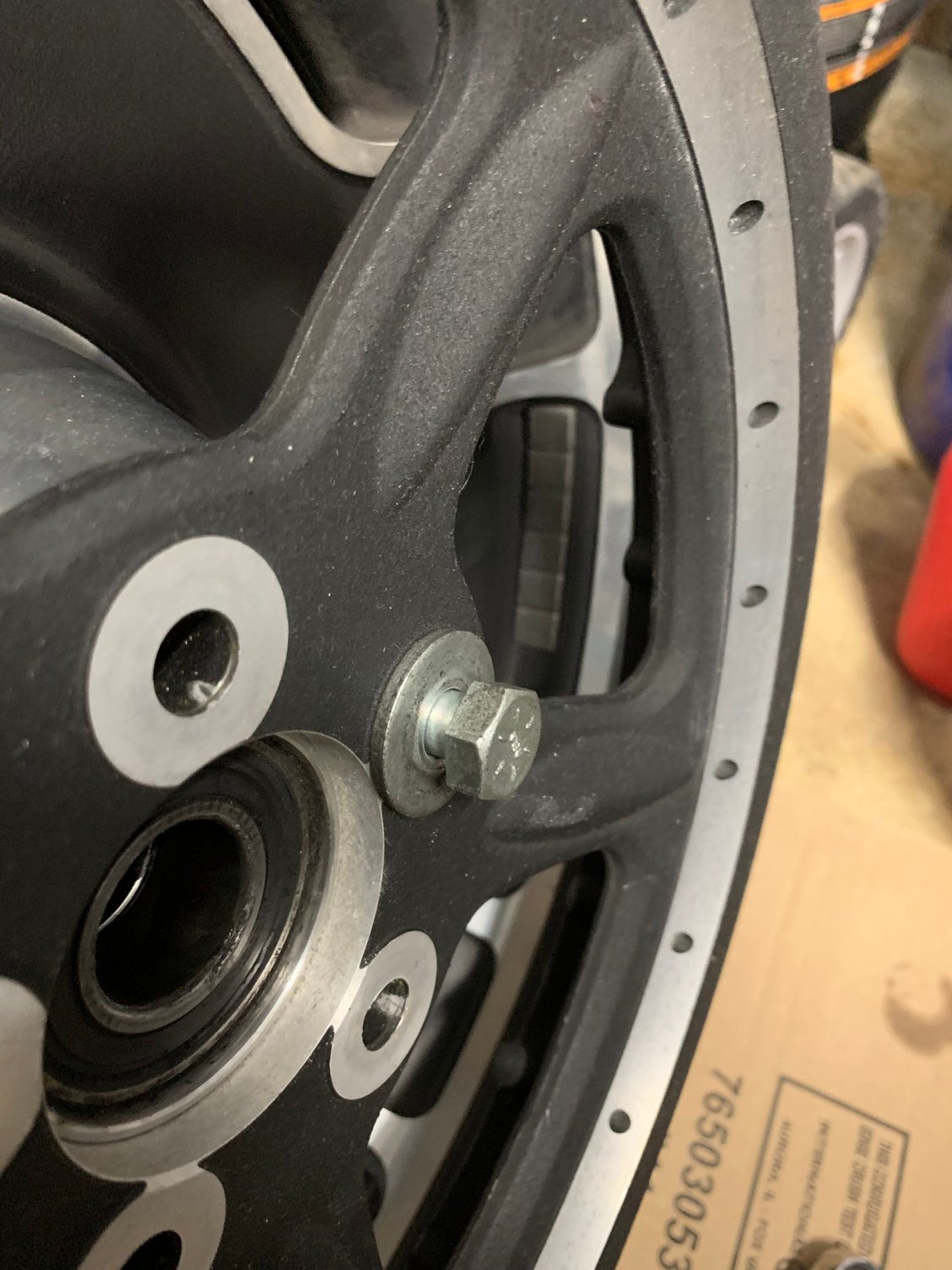

Was mocking things up on the ‘09 Nightster pulley swap on my ‘07 street glide and stock bolts (‘07) are to long. Do I have to use sportster pulley bolts? Didn’t read anything about this everywhere I researched on this swap.

Shorter bolts are required when using the sportster pulley, .25 shorter IIRC

Found my old post https://www.hdforums.com/forum/touri...l#post15957932 7 1/6 x 5 x 2 bolts are used
