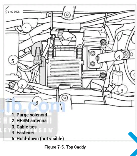

Ok so new batteries are in fobs, and I still have to enter my code.

Remove your seat, and ensure the HFSM antenna is firmly mated to its connector. Also, orientation is important. It attaches to the front of the top caddy in a horizontal position.

[QUOTE=barneyboy;18129436]Remove your seat, and ensure the HFSM antenna is firmly mated to its connector. Also, orientation is important. It attaches to the front of the top caddy in a horizontal position.
I will look at this when I get back home. Thanks for the info.
