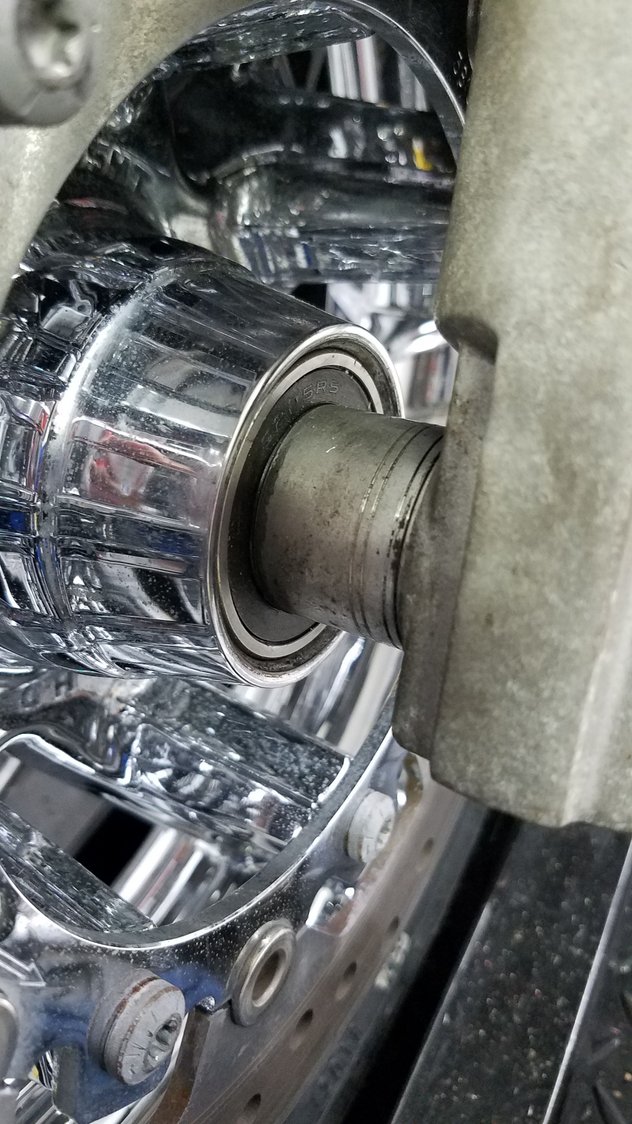

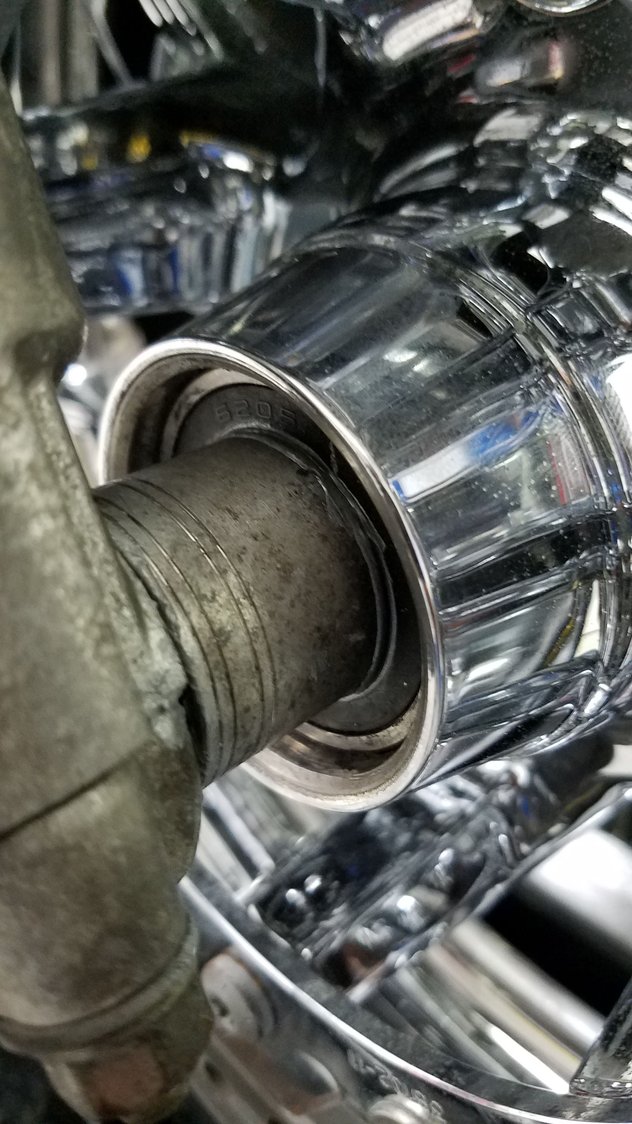

Well guys for whatever odd reason the wheel still isn't on.. Bates has talked to me on the phone and texted numerous times to help me out, he's voiced every possible issues he's encountered or thought of and for some reason this conversion isn't lining up right.
The first go round the bearings were installed in thr wrong order which caused the brake side to seat OK too far. With that fixed the issue is still the same. Brakes aren't sticking or anything, the entire set up it just shifted to the brake side.. I'll attached a pic of each bearing just to show their depth. As of now all that is installed is the non abs all ***** bearings, crush tube and stock spacers. I'm thinkin about using the old abs bearing on the brake side to push it over, maybe that'll line it up, instead of throwing a washer type spacer on this side

That still doesn't look right at all. Since your guy is 2 for 2 on installing them wrong, maybe try taking the wheel to Harley. Have them verify you have the right spacer tube and have them install new bearings - the right way.

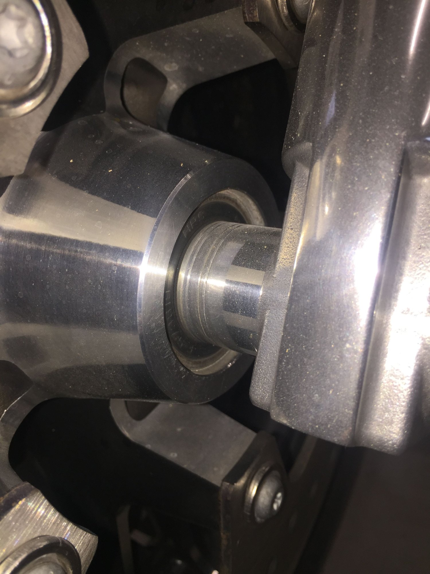

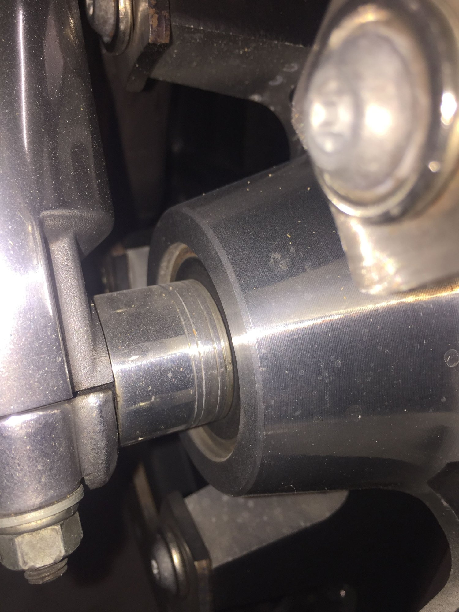

It sure looks like your depths are off. Here is my 08 with a 19" wheel, which was a straight swap for me.
