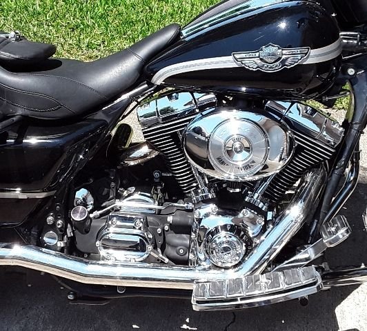

I love the look and sound of true duals. I have Vance and Hines on my 2003 RKC. The bike performs well but of course there are those who want to squeeze out as much torque as possible and we have all heard that True Duals is not the way to get that. Fair enough, the science doesn't lie nor does the Dyno sheet so here is my possible fix if I may to this. Given there are several exhaust options where by the cross over goes under the chassis, why not make a crossover pipe to connect the true duals under there as well. You retain the look. You don't have extra heat on the right side and the torque numbers logically should rise again given the exhaust reversion is then addressed. Seems too simple a fix for it to work doesn't it. ("Occums Razor" in philosophy states that all things being equal usually the simplest solution is usually the best.") Just a thought.
