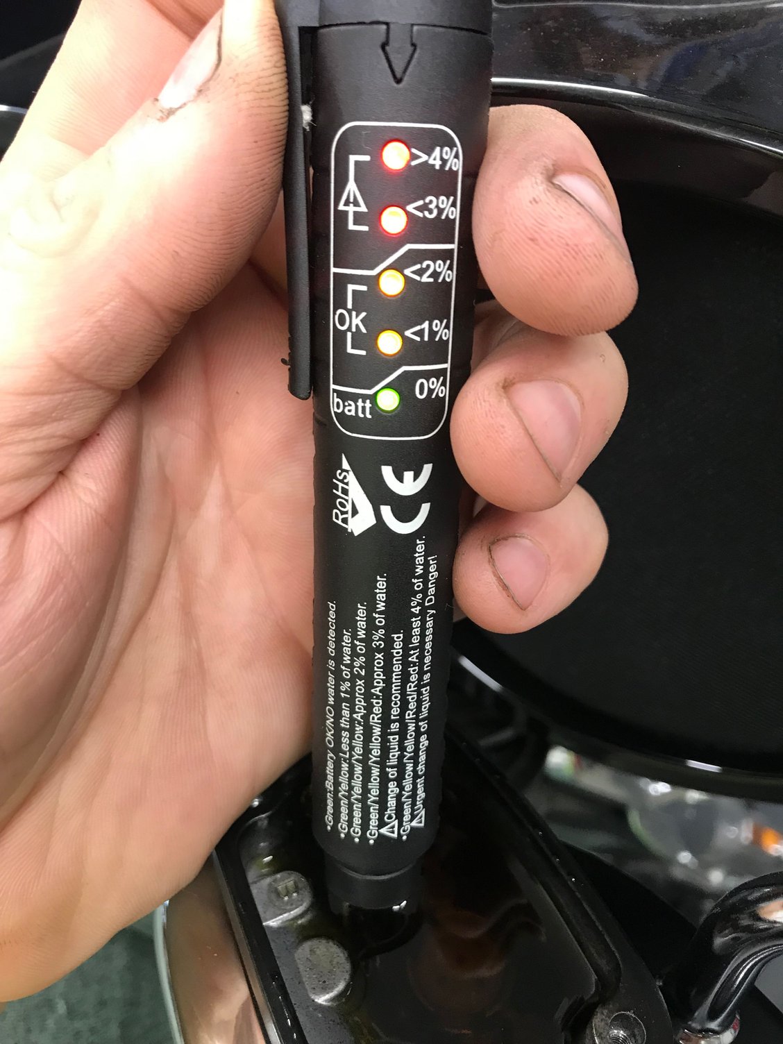

Bought this bike new November 2018, manufactured July 2018. Tested and flushed my brake fluids today, 23 June 2019 at 6,853 miles. Both front and rear failed with moisture content >4%. Those of you that think flushing your DOT4 every two years is good enough, especially if you live in a humid climate, think again. Harley's recommendation of flushing every two years is stretching it.
I usually test my brake fluids new after I open the bottle too. They usually already test at <1% of moisture content, sometimes <2%. Today I used Motul DOT4 660. This is the first time I've tested a DOT4 brand new with 0%, I'm impressed. If you use the prong tester such as in the picture, be sure not to touch the prongs to the master cylinder walls or you'll get a false failure reading. I'll be curious to see how the Motul 660 tests after a year in Florida.

Originally Posted by GalvTexGuy
I tested my 1-1/2 year old brake fluid a couple of weeks ago when I changed the brake pads and it was <1%. I live along the upper Texas Gulf coast where the humidity is almost always high. I do plan on flushing it in the very near future.
I test on average 4 to 5 bikes a week. I can say I’ve never tested a bike with 1 1/2 year old brake fluid at <1%. Did you fully submerge the test probes into the fluid? If only the tip was submerged, it’s not accurate.
Case in point sir, I flushed by clutch hydraulic fluid today. I took pictures as I progressively submerged the prongs on the DOT4 tester. With just the tips in the fluid, it tested <1% … when I fully submerged them without touching the master cylinder, it registered the true moisture saturation of the DOT4.
I tested another newly opened bottle of Motul DOT4 660, again it was 0%. Can't wait to see how it tests after a year in Florida.
I don't know what I did wrong, but you are right. I tested again and it pegged the meter at >4%! Thanks for checking me. The fluid still looked good, though.
