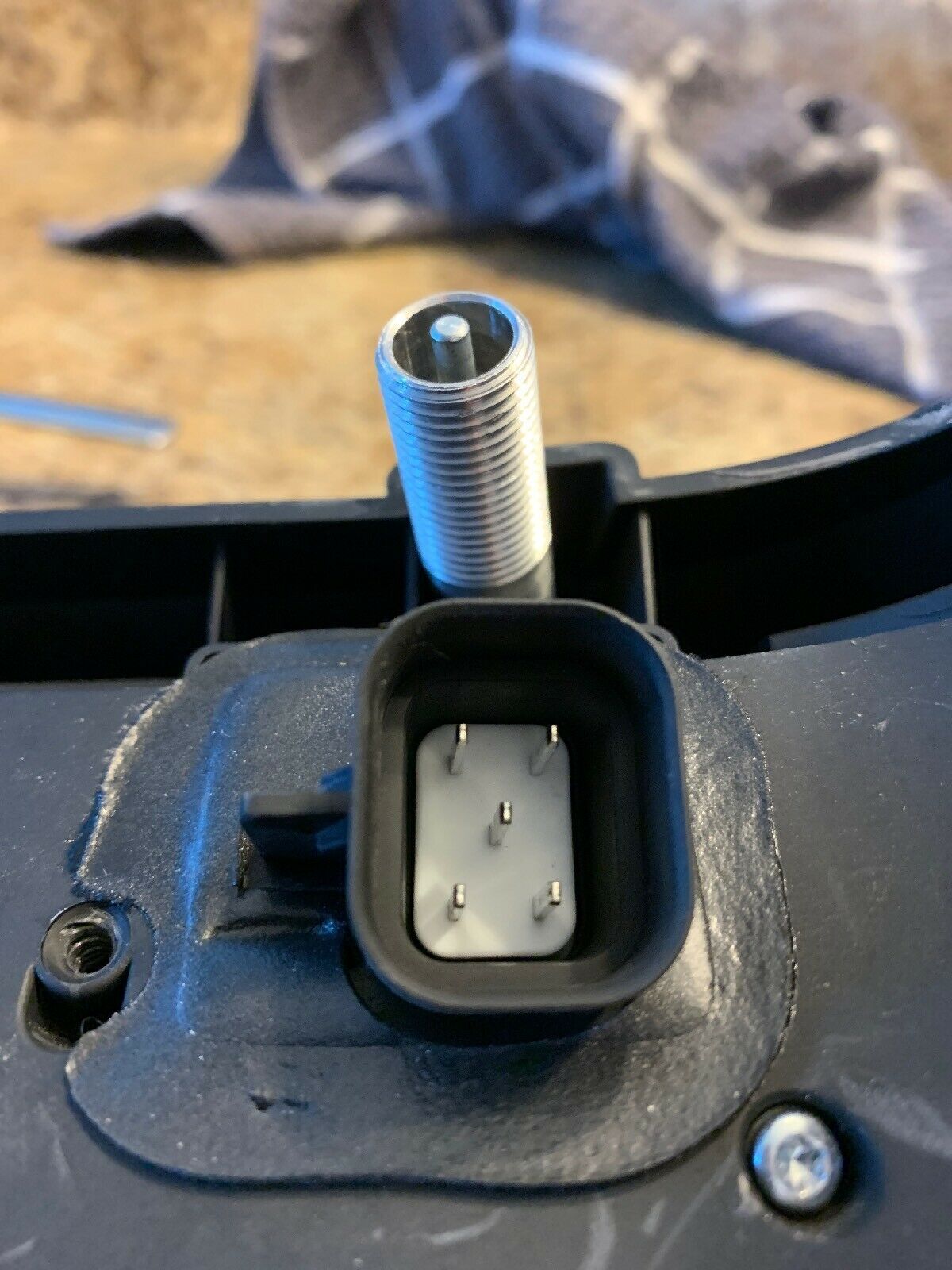

I bought a Wrap around Brake light for my 2015 SGS, # 67800093 and I can't find the connector as seen in the pic... my manual states a Delphi 150 Metri-Pak 5-way and I can not find this anywhere.
So, any help would be greatly appreciated

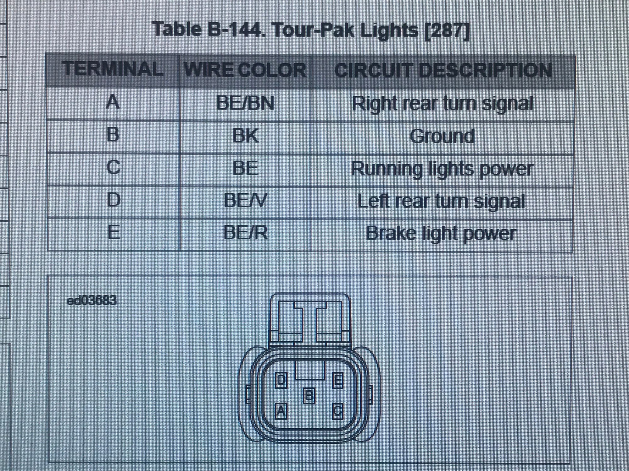

Cool thanks, do you happen to have the pin outs or model year for the 5-way connector?

Its an end view so you're looking at the end that actually plugs into the light (not the side that the wires feed into), the wires come in from the back or away from you in this pic... if that makes sense.

Its an end view so you're looking at the end that plugs into the light, the wires come in from the back or away from you in this pic... if that makes sense.
Aweseom, thanks a million!

I believe that would translate to this...
