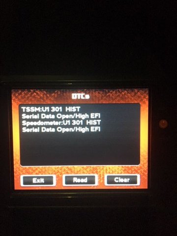

Checking to see if I had any codes using my powervision and saw that I had a u1301 code and it's Serial Data Open/High EFI. . Serial Data Open/High Speedometer. What could be wrong? I have searched to find out what that code is related to but can't find the info or I missed it. Any
help would be great. Thanks.

Is your bike having any issues? If not, just clear the code.

Can't tell for sure what you are riding. Serial data for the speedometer is also used to adjust radio volume for speed and for auto cancelling of the turn signals. Is the speedometer acting up at all, turn signals not cancelling as dependably as they used to? Looks like you don't have a factory radio. As suggested above, cancel the code and see if it loads again. If it does, the speed sensor may have a problem, a dirty connection or fouled with metal filings/dust generated inside the transmission. If the sensor is contaminated, we cheap guys will clean the sensor and change the transmission fluid and try again before replacing the sensor.

did you ever figure Out what the problem was? I’m getting exact same code on my PV. I go to clear the code and no luck. Comes right back

Did you ever figure this out? I just changed bars and grips on my bike and now I'm getting the same codes

I needed to update the software on my power vision tuner snd it Went away.

I will try that next. My bike is behaving as it always has, I only noticed the U1301 codes because I had another unrelated code. Thanks
