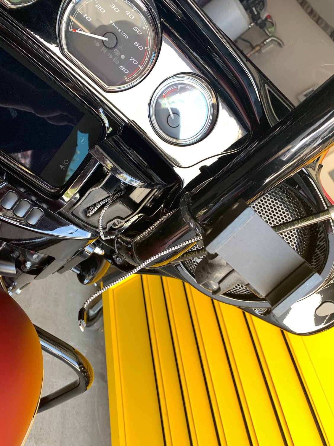

I got a shorter charging cable from Amazon, with a small round file I cut a small groove in the plastic, zip tied the cable to the bars, problem solved. The door opens/closes like it's not even there.

I took out the grey foam padding which exposes a small hole on each side of the compartment..,then just run the cable out the hole to your handlebar, you can put the foam padding back in once you’ve run the cable through the hole and then just close the door. This works perfectly with an iPhone lightning cable because it’s so small and will fit through the hole and IMO is a better alternative to cutting a notch in the door.

I had actually filed a notch in the compartment, not the door, and it worked pretty well. But, I liked your idea better and just finished rerouting the cable. Thanks for the tip.

^^^^^^^^^ This 100x ^^^^^^^. Also, purchase a flat cable from Amazon...makes it easier to thread and will also (IIRC) allow the door to shut should you decide to route it that way.
