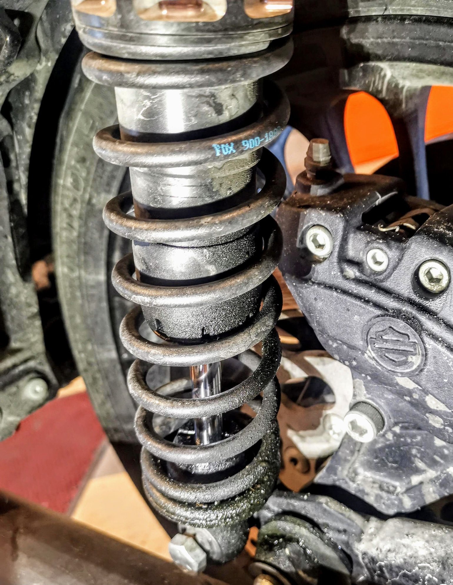

Be aware. Installed this winter. Fox Shox Preload Adjustable Standard Shocks 13" #897-27-002, 2018 Road king Special. Went with the 13" for more travel. Initially very happy. Less than 4000km's on them Both leaking and not performing well. Back to stock I guess.
I I have about two thousand miles on mine and they are perfect. I had a little problem with fitment with Street Cannon mufflers ....call fox
