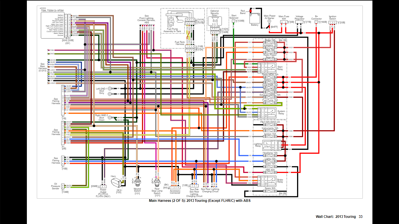

Checking current draw can be difficult, setting up the meter, reading the scale. Are you sure you read Amps and not MilliAmps? The positive does go to the started before the main fuse but how could you have a short drawing 5A?
https://video.search.yahoo.com/searc...0&action=click
I'll post the main schematic for 2013 Touring. Pull the main fuse and set up your meter to measure current. Insert your meter leads in the fuse holder so now all current will be going through the meter. What do you measure?

Actually the way I'm reading the schematic in the service manual, there is a connection before the main fuse at the starter or relay. Checking that this morning. Have a charging pigtail on the ground also, now unhooked. Using a digital multimeter set on the 10 amp connection inline at the negative terminal. Indicates 4.69 amps.
It is definitely reading 4.69 amps. Thought I was seeing things also. Seen the starter connection on the schematic last night and will be checking that this morning. I've been doing my check between the negative battery terminal and cable.

Thanks for suggestions so far. I'm going to check the surface of the positive cable to the main fuse input including the connection at the starter today. I must be missing something somewhere.
