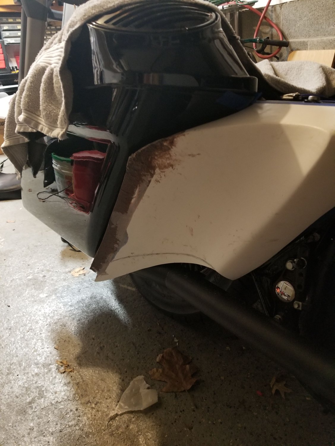

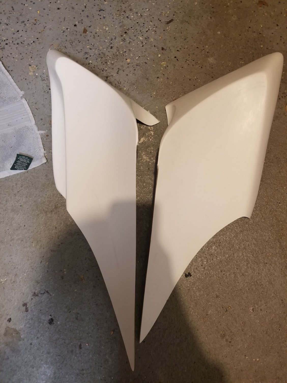

What's the best way to trim the bottom of these ? They extend about 1 inch past the bottoms of my stretched bags. Any ideas.
Also, there is a slight gap between them and the saddlebags. The company said I might have to "add" to the covers. Has anyone done this ? Worked with fiberglass? Just seeing if I'm over my head at this point. It's been a long road trying to find side covers that work.

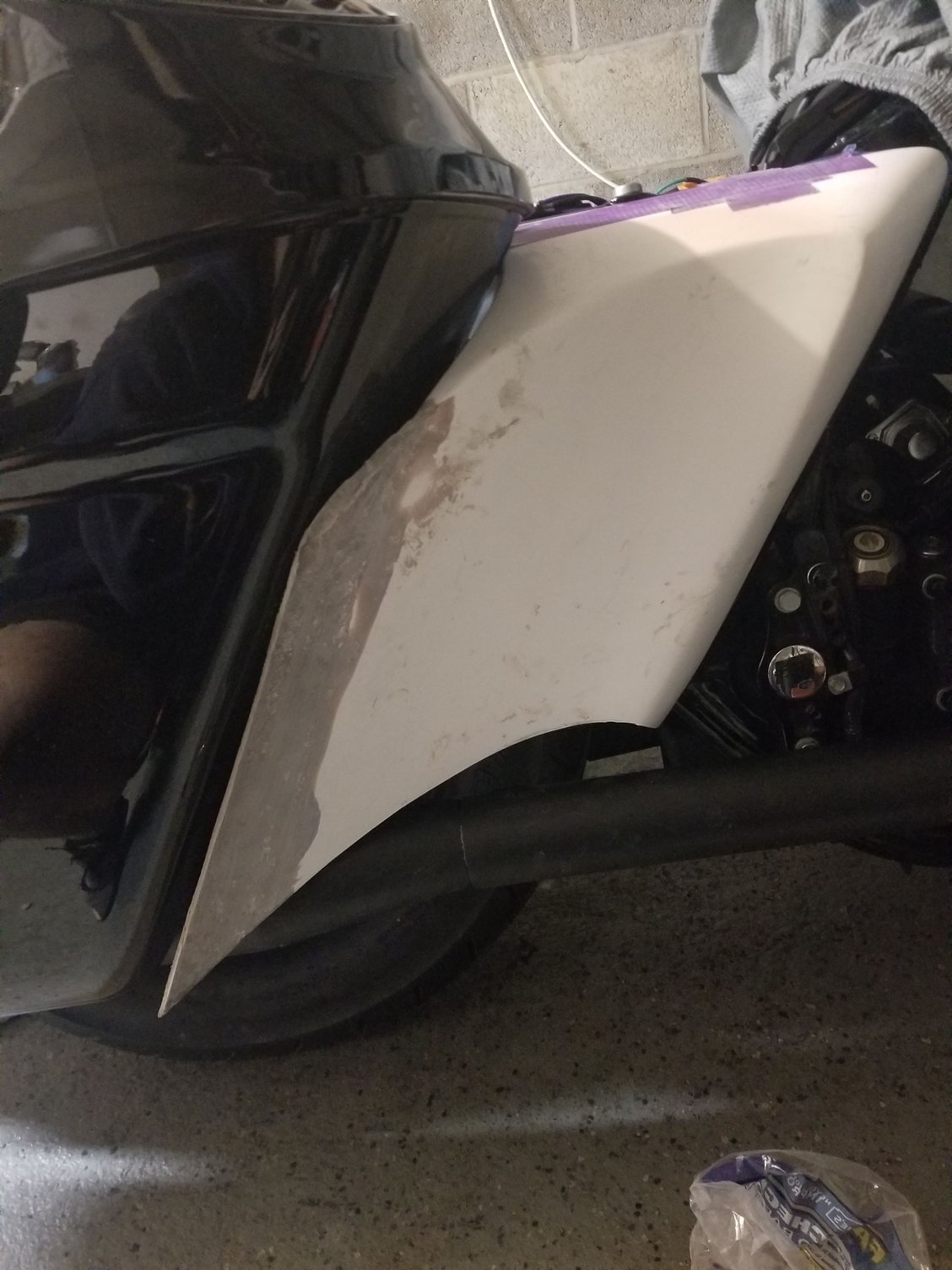

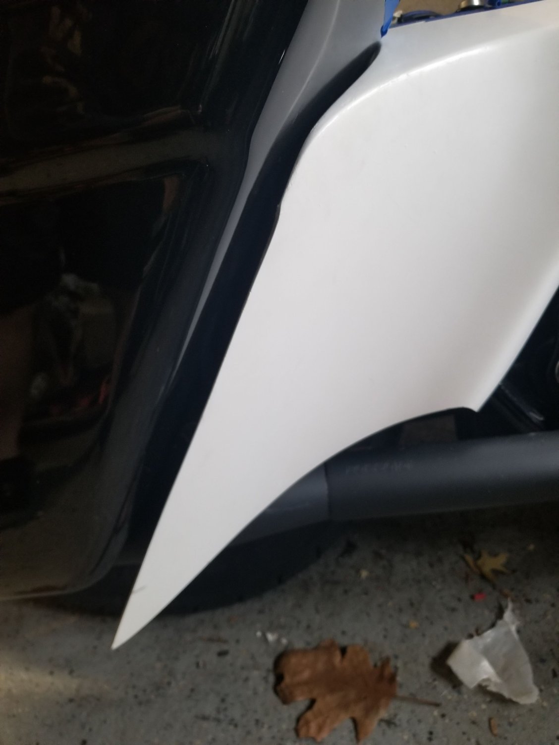

Jumped into the deep end and got started. My progress so far
Still needs to be trimmed, sanded , etc

Yea I've done a few sets. It looks like your headed in the right direction. Those side covers obviously aren't designed for those bags, and although you can cut and shape them they will still look a bit out of place, unless you reshape them to match. Voodoo (and others) make side covers that will match the bags, although you will still need to shave about 1.5"s off the bottom but will look better when done. As far as the gap between the bag and cover you can mold the two together, which is done on many custom bikes.

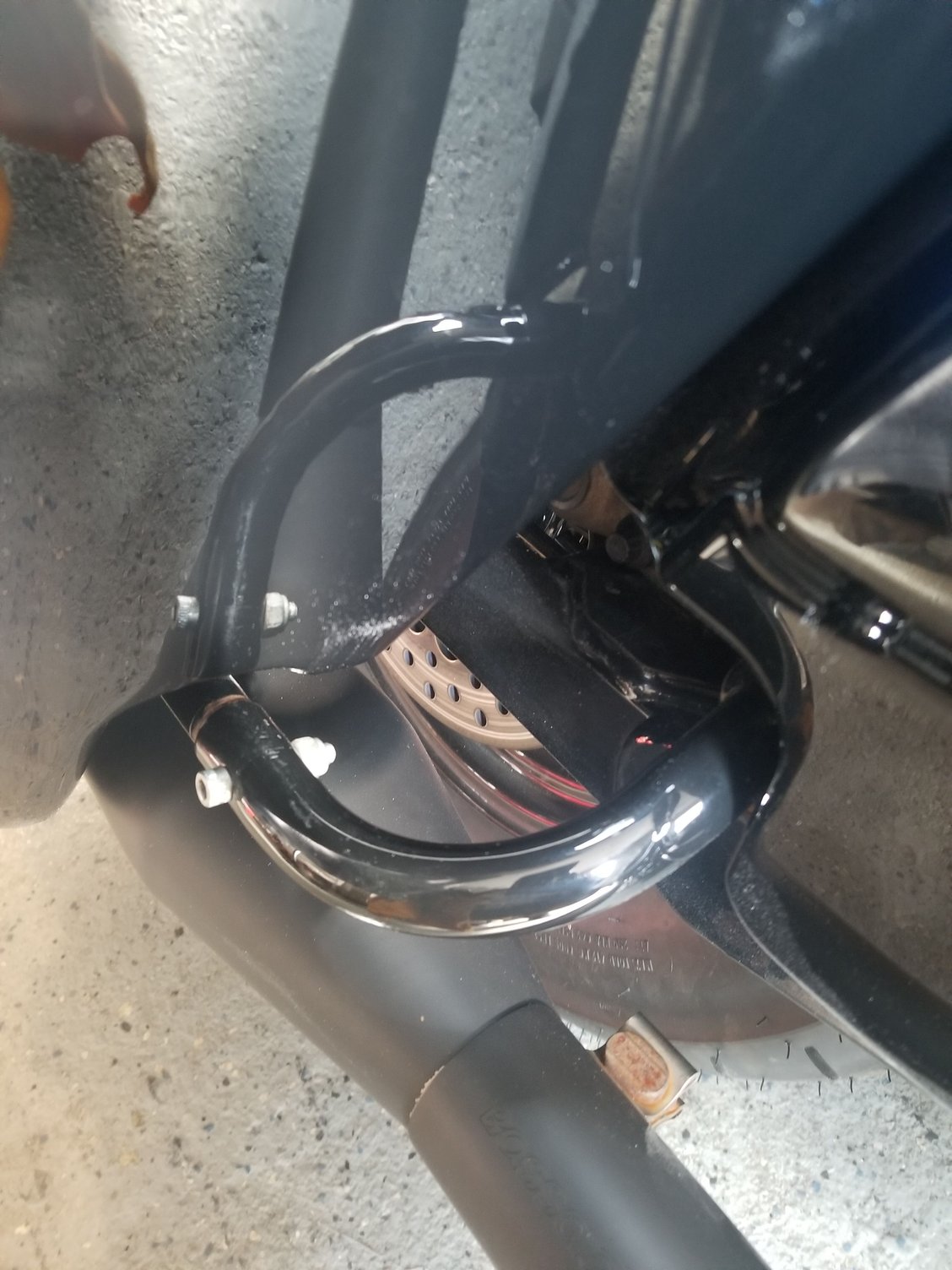

Thanks making progress with mine. Dealing with the rounded saddlebag rail getting in the way now.
