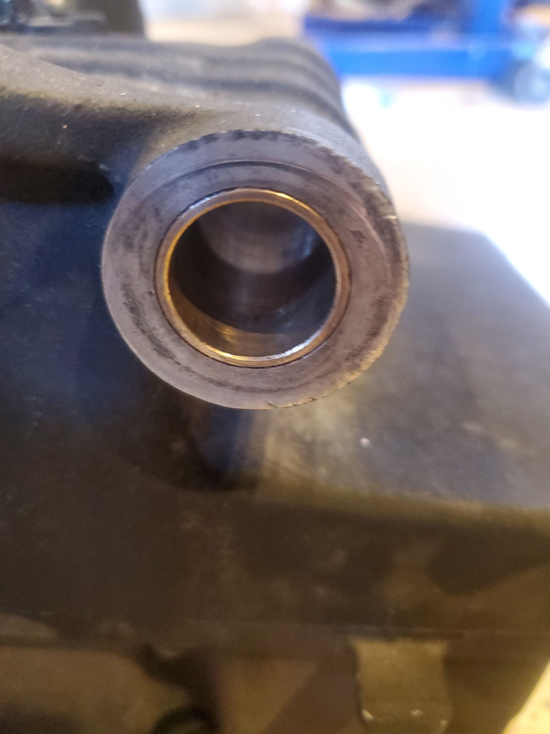

Just to update, got the glide pro parts the other day, and just had time to take the piviot shaft and the trans to the machine shop. Hopefully itll be back next week for assembly.

Just to keep it updated. Got the trans back from the machine shop, put in brass bushings. Shiftvfits nice and tight now no slop. Just need to get the time to install it all.
