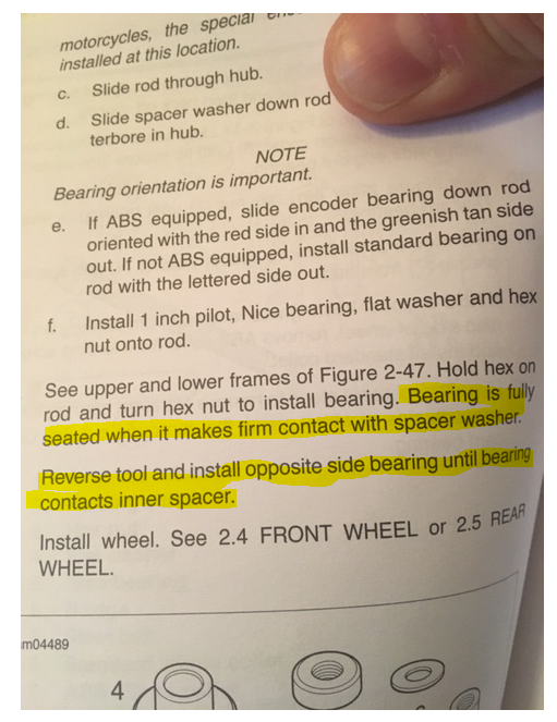

FYI:
Old Mar 13, 2020 | 06:47 PM
sanman4ever's Avatar
sanman4ever
Joined: Apr 2012
Posts: 3,461
Likes: 329
From: Rhode Island
Originally Posted by Imold
I forget offhand which bearing goes in first and bottoms out for a dual disk big twin, but it's in the manual.
Always install the bearing on the primary brake disk side of the wheel first

If you're interested in the process to install wheel bearings and, particularly, how the bearings are set against the spacer, here's a good video.

Don't take offense, but unless that bearing was Grossly mis-installed (for visual analysis) or you had a prior external measurement for a reference, one would not know that second bearing was the bearing in question.
With that said, it would be highly unlikely for the First bearing to be installed "short" (because of the process)
People make this so difficult, when all you have to do is turn the "installers" around (yes, backwards) when "seating" the bearings ... then you don't have to "Creep Up" on the spacer sleeve
