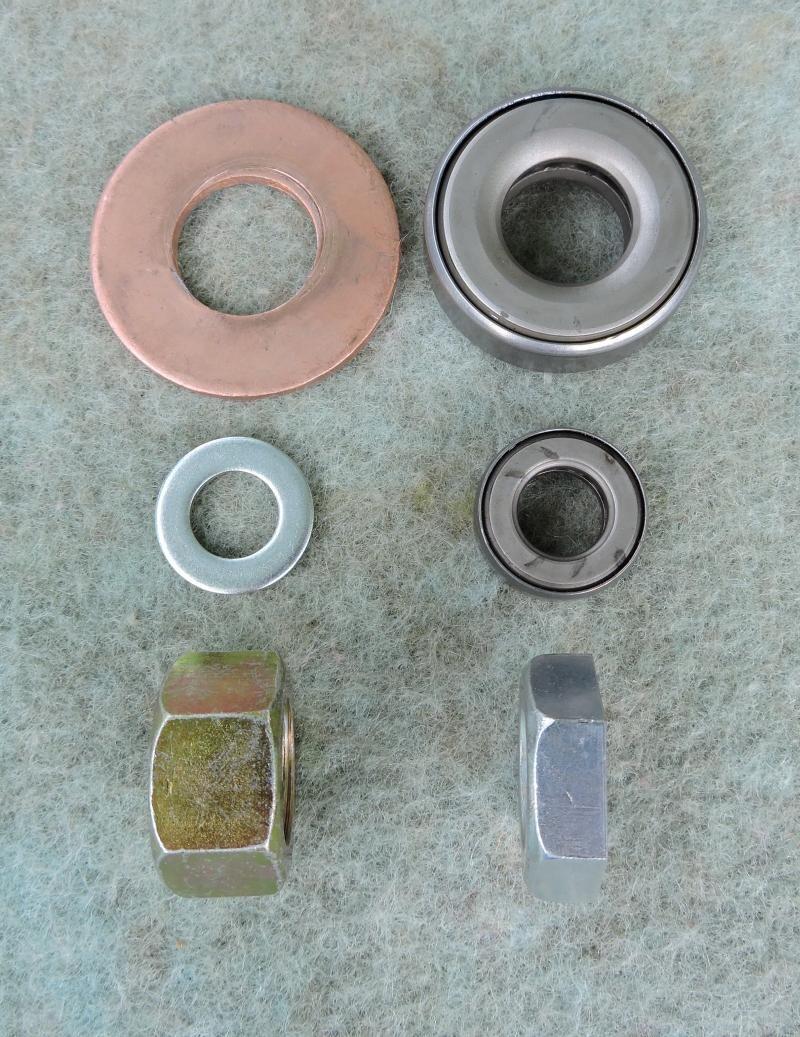

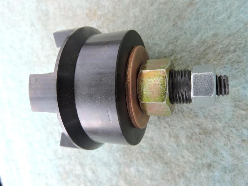

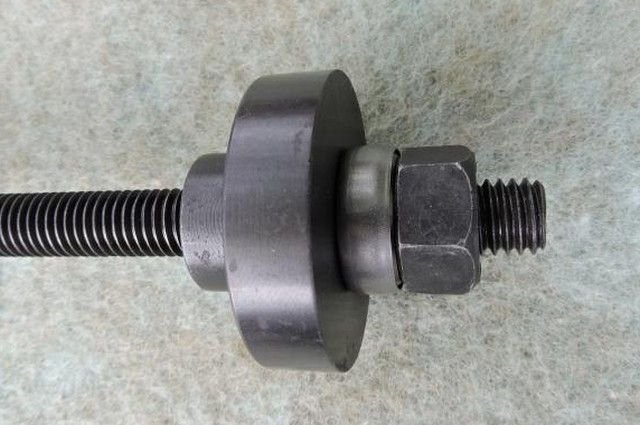

The Plain Washers work fine, but I usually swap them out for Those "Nice" brand Thrust Bearings. They're actually pretty inexpensive.
With STD washers
Replacement parts
with Thrust Bearings in place
