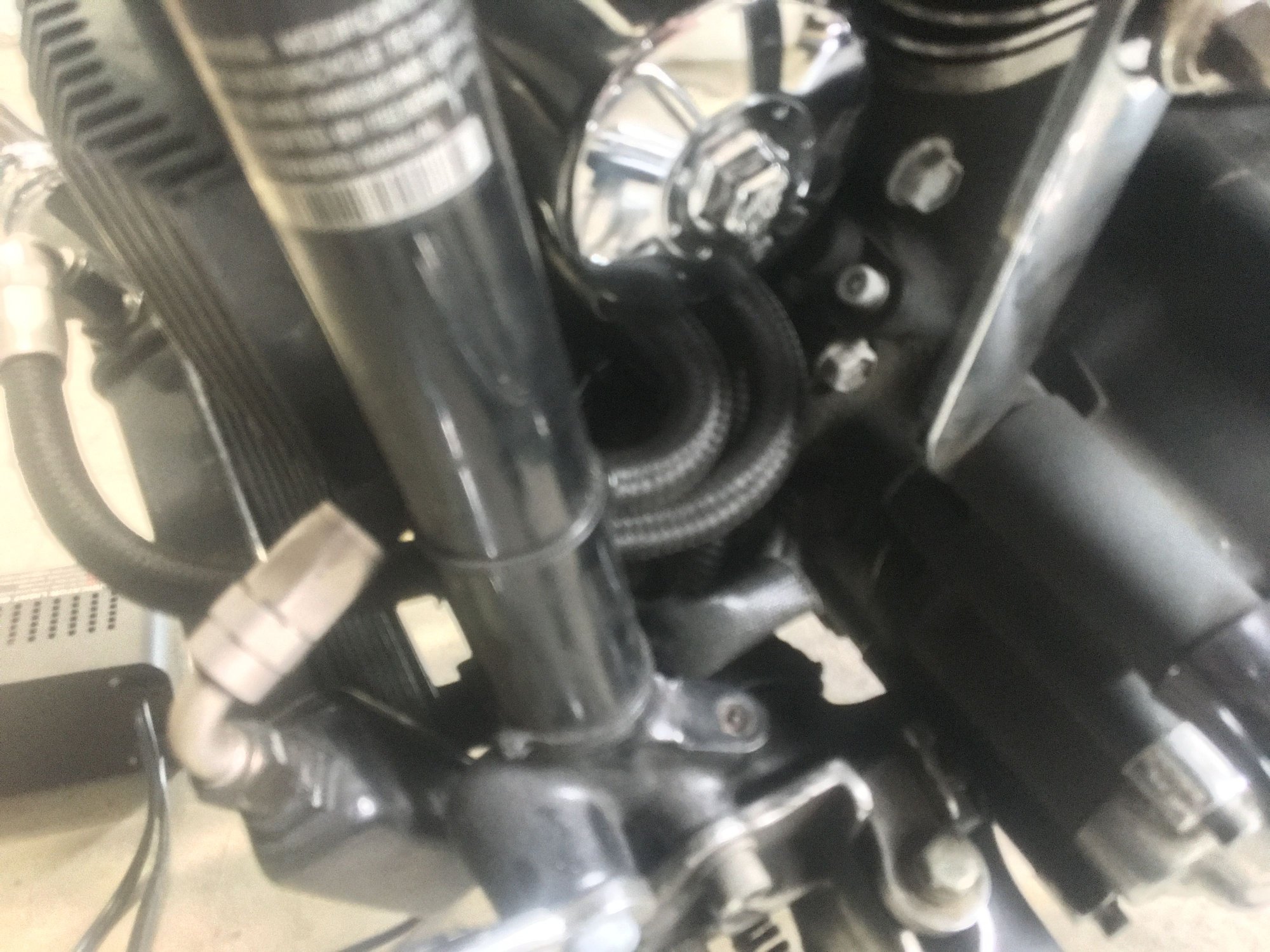

I was able to get the front mount installed tonight. The washer for the nut under the oil filter was in a recess in the mount where I couldn't see it. I took it out and was just able to install the bolts. Hopefully it won't rain tomorrow and I can get a ride in to check out the improved handling.

Just wanted to follow up and close out this thread. The mods made a big improvement in the cornering stability of the bike. It used to feel like it had really bad swing arm pivot bearings in and the swing arm was moving side to side. The True Track front and rear stabilizers took all of that out. I'm certainly no road racer and I don't "drag pegs", but I now know that it will hold whatever line I choose in a corner. It was bad enough that I was seriously considering selling the bike. Now that I'm going to keep it, time to dump several thousand into it!

Howard at Motor Cycle Metal is who you are referring too. After many different set ups my current suspension set up has been much improved from stock. I'd like to install the front stabilizer not sure it will fit with my Jagg Oil Cooler.
