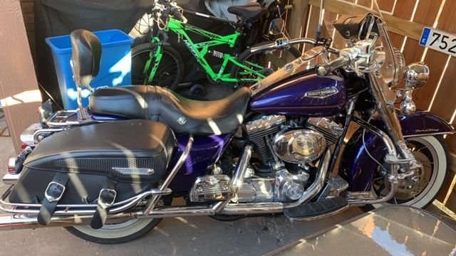

Originally Posted by pato69mx
Hello to you all, first post here as I just got my first HD after riding metrics my whole life.
I'm having problems finding a TPS for Jessica ( yes bike was named by the late previous owner and I kept the name to honor him) according to his wife the bike is a 1999 1/2 so it has some factory upgrades towards the 2000 model.
Attached are a picture of the bike and one of the place where the TPS goes.... any ideas which is the correct TPS for this bike.
. Post on the Evo forum. Several guys can point you in the right direction. Many will say carb conversion. My 98 Ultra with MM EFI runs just fine after some attention. If you have deep pockets, you can consider the conversion. Ken
