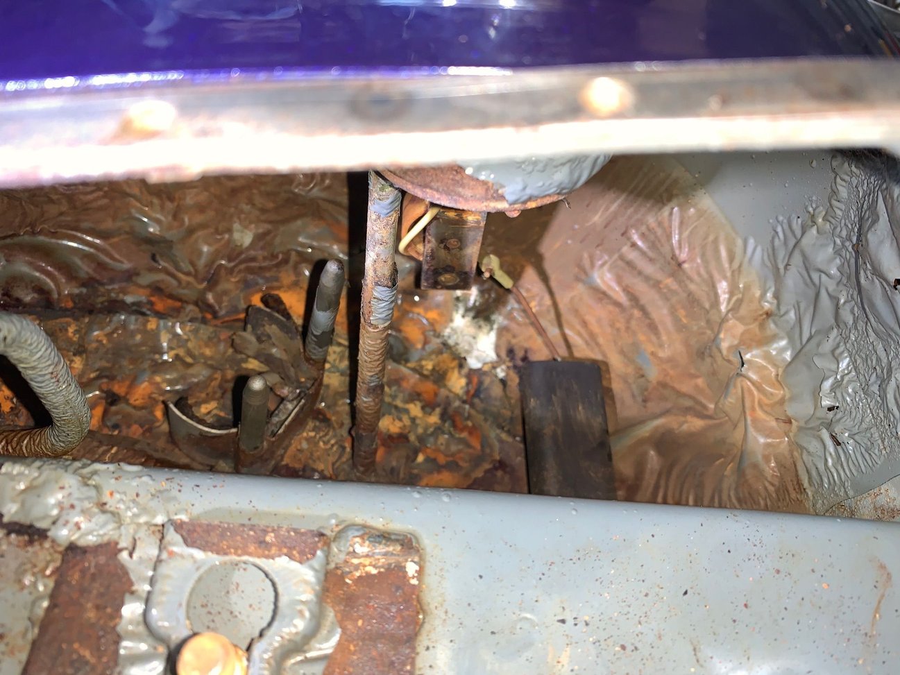

Now my issue, as some of you may remember when I bought it Jessica had been sitting for over 2 years on a storage container with fuel on it.... thank was really bad inside... took it out, acid cleaned it, recoated it, new fuel pump and everything worked, the issue is the Cup where the Fuel Gauge sit is the kind that has an opening in the middle for the fuel gauge sending unit (I think that comes only 99-01 for the Magnetti Marelli Fuel Injected ones)... long story short I cant put more than half tank of gas as if I do it starts leaking thru that hole or screw holes and from there thru the little tube for the wiring. So #1 Fuel leak and #2 I can't ride more than a 100 miles without refueling.
Any ideas? I've been looking all over for a new or in good shape used tank with no luck.... I need two lines on the bottom, and that kind of Cup for the sending unit.... does anybody know who or where can I look for it... So far eBay only have one but seller hasn't responded to a couple of questions I have.

Your missing gasket 13, hence 61324-88a and it should be under the lower ring, so chances it's in the wrong spot, or if in the correct spot, may need to use some RVT with it.
Note, O ring 12 is just the beauty ring for the gauge, to keep up in slightly off the tank surface, so it goes on the bottom of the gauge when you snap it in place.
On the bolts, use some RTV on them, to seal the bolt heads mating surfaces to the fuel sending plate (so the fuel does not wick up the bolt threads).
Really, just take a photo or two of the install of the tank fuel sending unit (how you have all the parts lined up in order, and even pull the parts so we can see the bolting flange in the tank for the sending unit), and should be quick work solving the problem of what is out of order, or missing isntead.

Man, you are always spot on with your answers, thanks DANO... I'll work on disassembly with pictures so I can show you the status of everything and get your opinion.
By memory I think have an issue here.... Does the fuel gauge sending unit base (33) goes over the bottom of the cup in the Tank, with the gasket (13) obviously between them?.. trying to be more clear, when installing the sending unit you put the gasket and then squeeze the sending unit through the opening in the cup from above?
For some reason I think this one is installed from the inside of the tank.....

I took the tank off send it to a fabricator and they removed the fuel gauge "cup" and the little pipe for the wiring and made a new one.... I finally can ride with a full tank (160-180 miles depending on speed) I still do have a very small leak (a drop every 5-6 seconds) when I top it off and put it on the Jiffy Stand, not with the bike straight up.... If I stop after riding 40 miles no more leak (obviously because the fuel level is lower)... again this only happens when i fill it up almost all the way to the hole... that I do by mistake when I'm riding longer distances.
