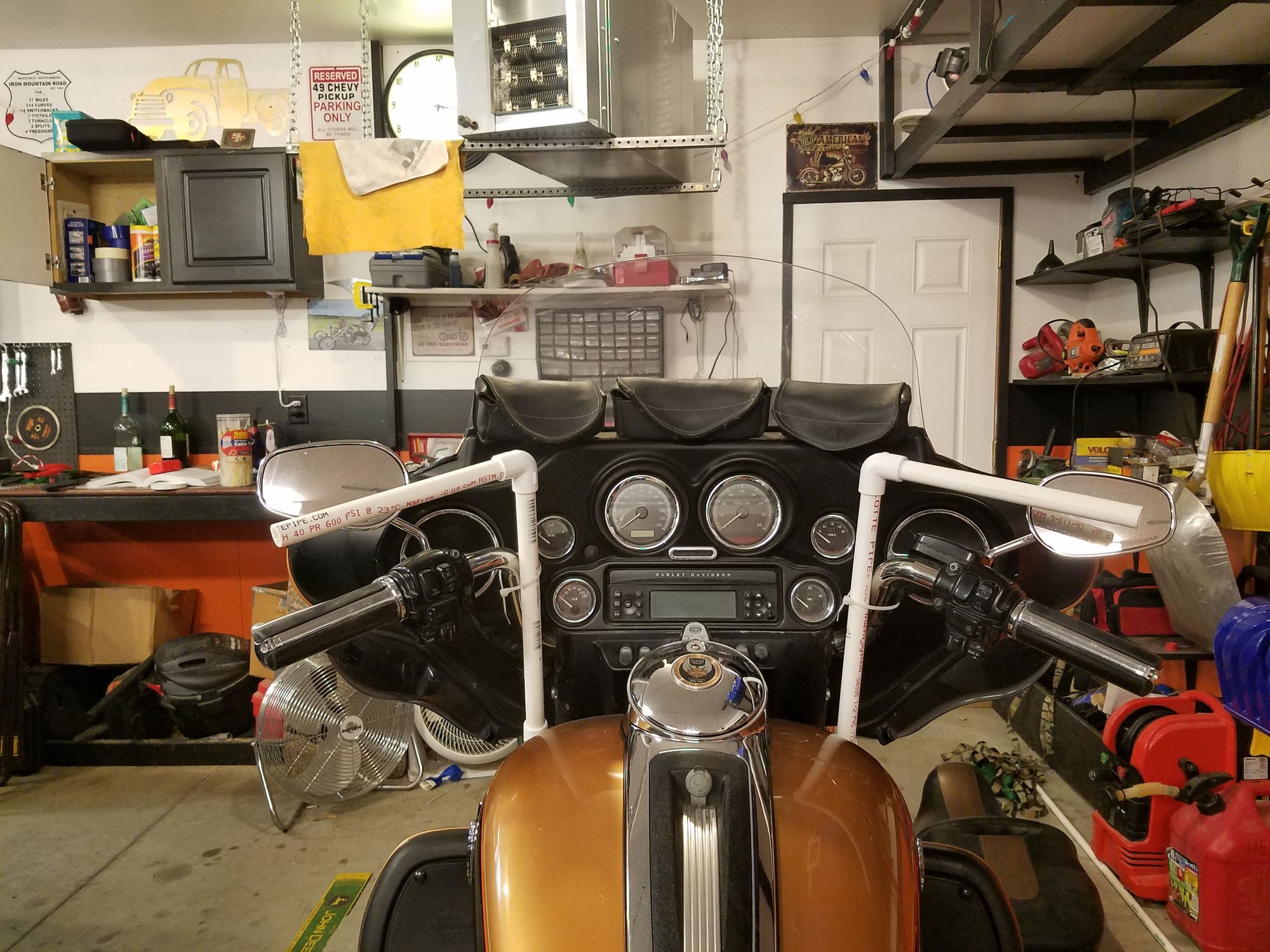

Here do what I did.
Go spend $10 on some pvc and some elbows.
I slide one through in front of the tank so as to rest of the neck of the frame. The put an elbow on each end. Then I used different lengths to figure out where I felt comfortable. Once I figured that out I zip tied the pvc bars to the stock and then measured for difference.

Crafty as hell
