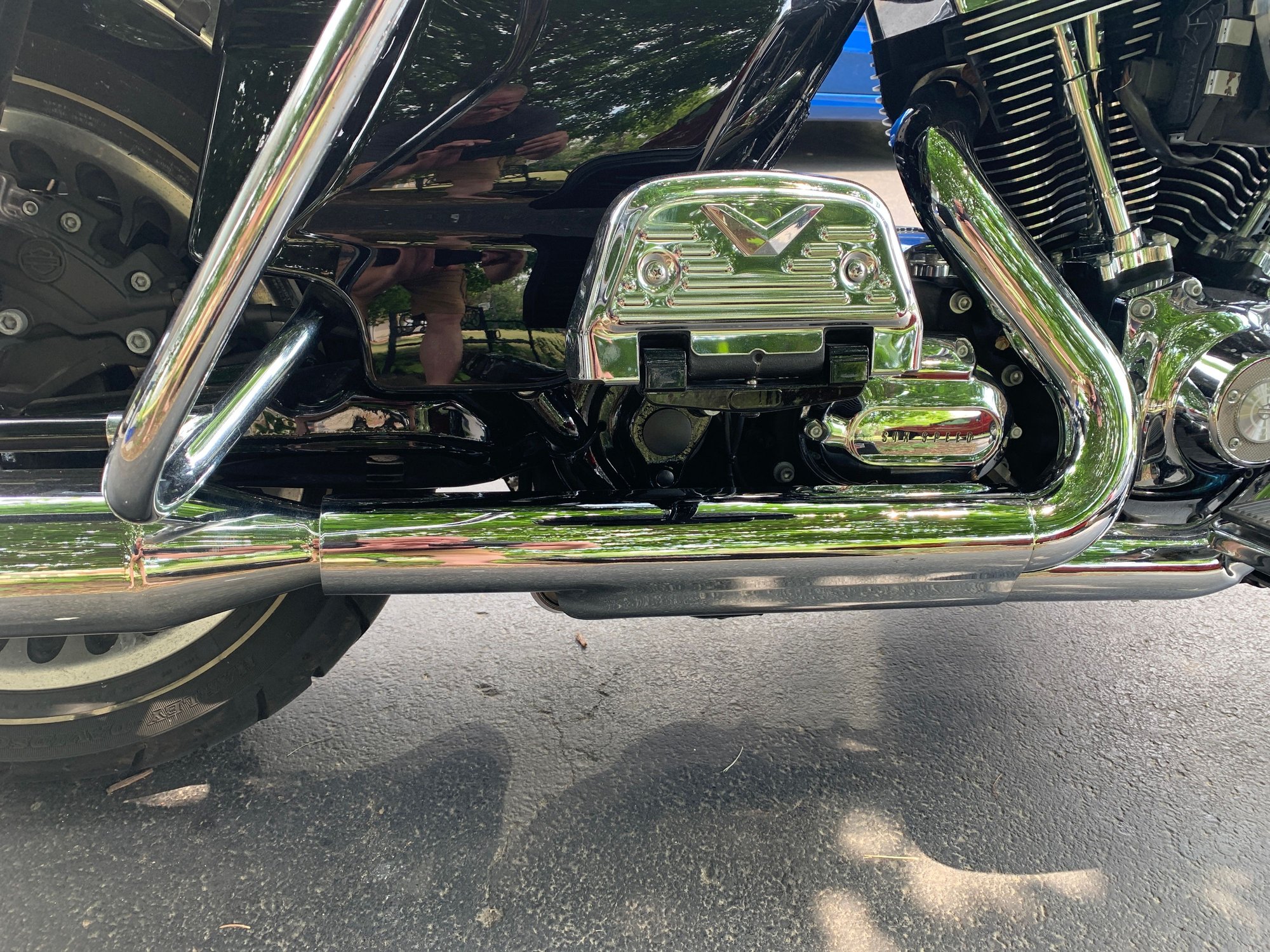

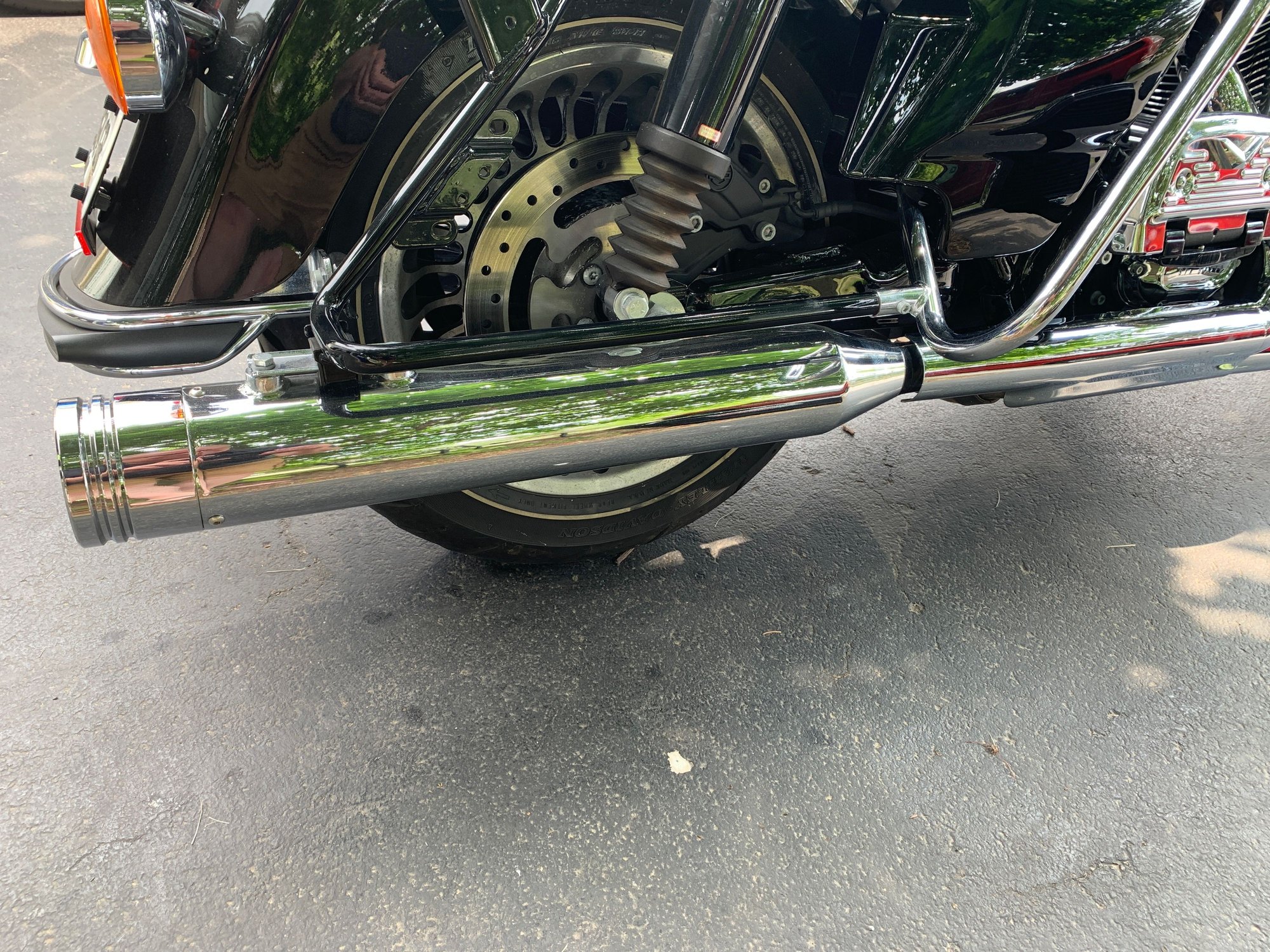

Ok back to the pipes...sorry my knowledge of Harleys is limited, that’s kind of why I’m thinking about doing this stuff myself as opposed to taking it to the dealer, to learn the bike. So if I choose to add slip-ons on, I should have it tuned as well? Will it cause damage putting them on then driving 40 miles to the stealership for the tune? Unfortunately I won’t be able to go to the same dealership to question about the “stage 2 kit” as it’s now out of business. Bought from Hal’s Harley in Waukesha, WI.

There are just too many inconsistencies in your description of the bike. Does it have stock mufflers? Does it have a cam? Why was that air cleaner installed? Was the bike tuned? Which tuner and where is it?
If all you want to do is put another set of mufflers on it, go for it. Then, ride it like you stole it. Good luck!

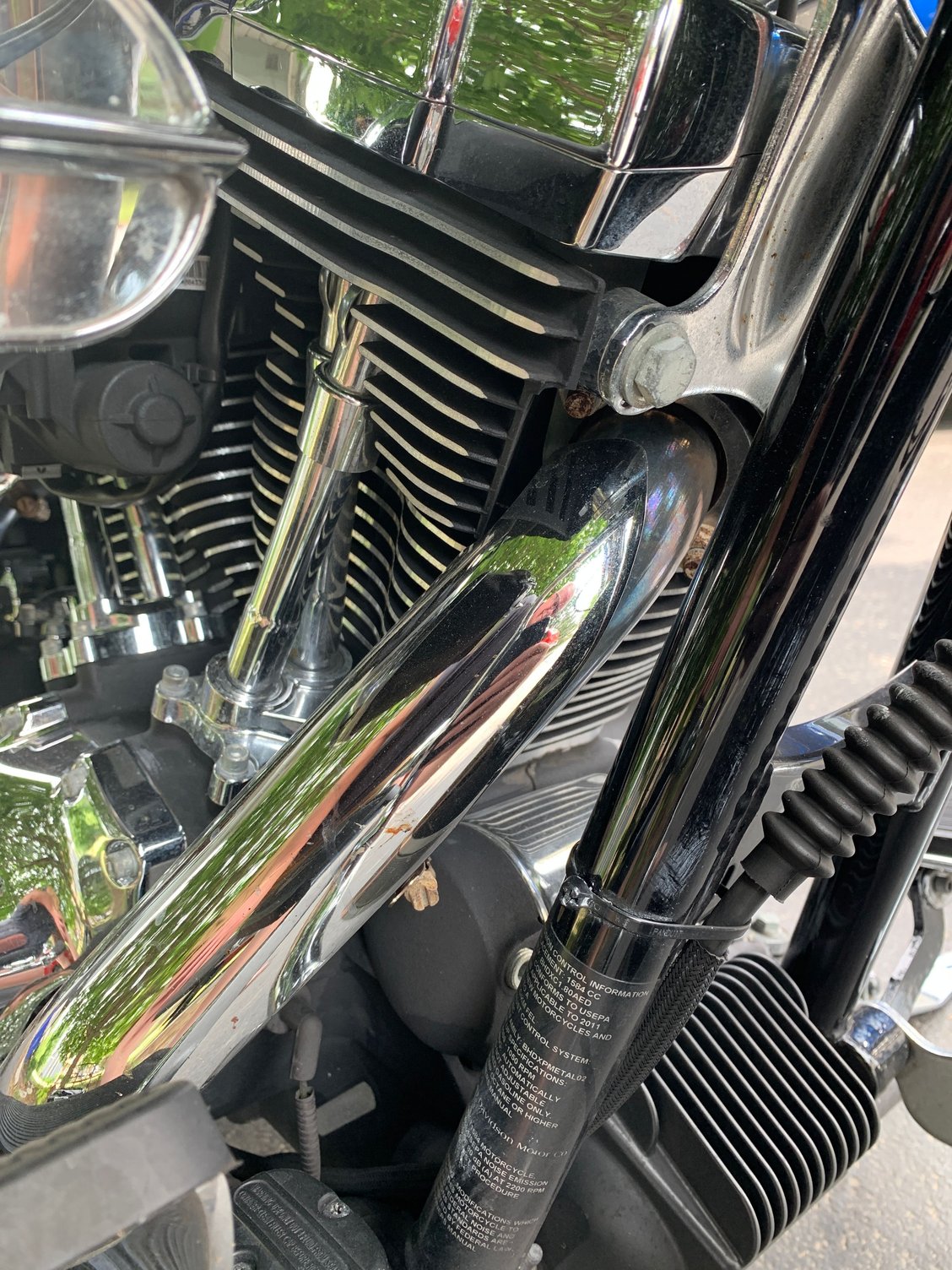

Thanks for the photos. Those are not stock mufflers. It looks like you do have the stock header, but you could have a Fuel Moto Jackpot 2/1/2 header under those stock heat shields.
Nevertheless, those look like Rush Big Louie mufflers judging from the end cap. If they aren't loud enough for you, Rush has different baffles for them.

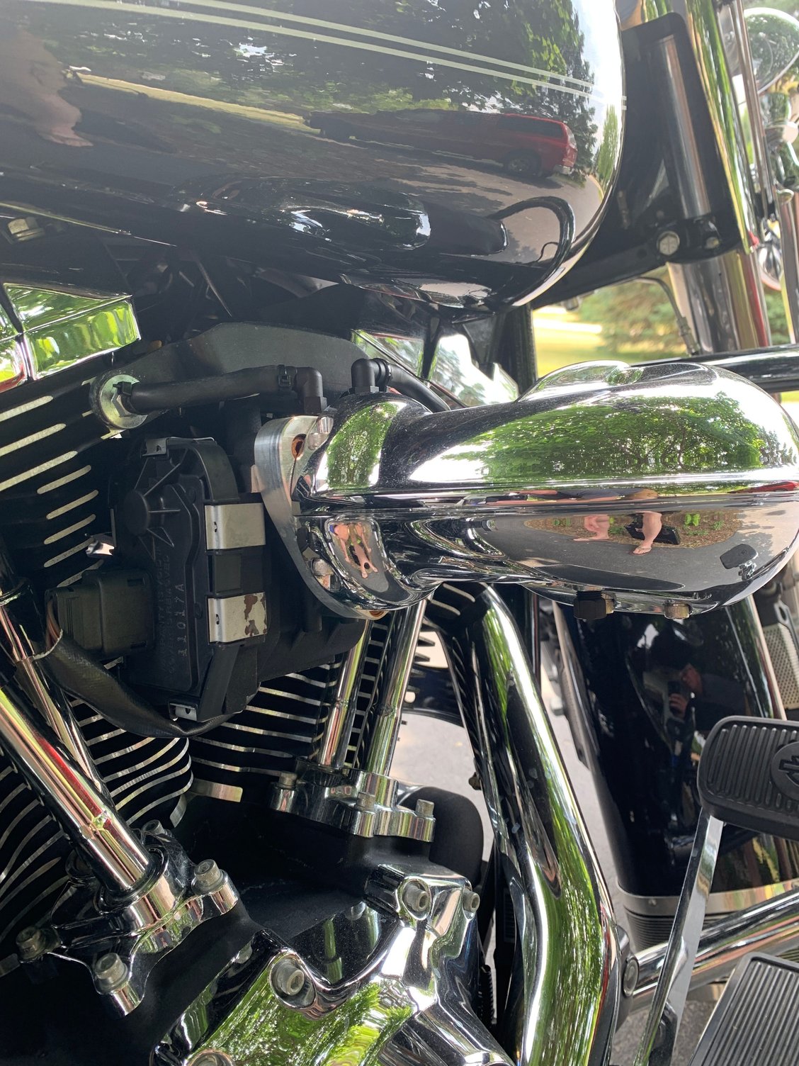

Awesome thanks for taking a look. I assumed they were stock as a salesman told me he thought they were. They do have a nice rumble, I personally would like a little louder rumble. I’ll look into my options. I do appreciate all the responses. I did look more into the air cleaner as well. It’s a kuryakan 9866 corsair air cleaner.

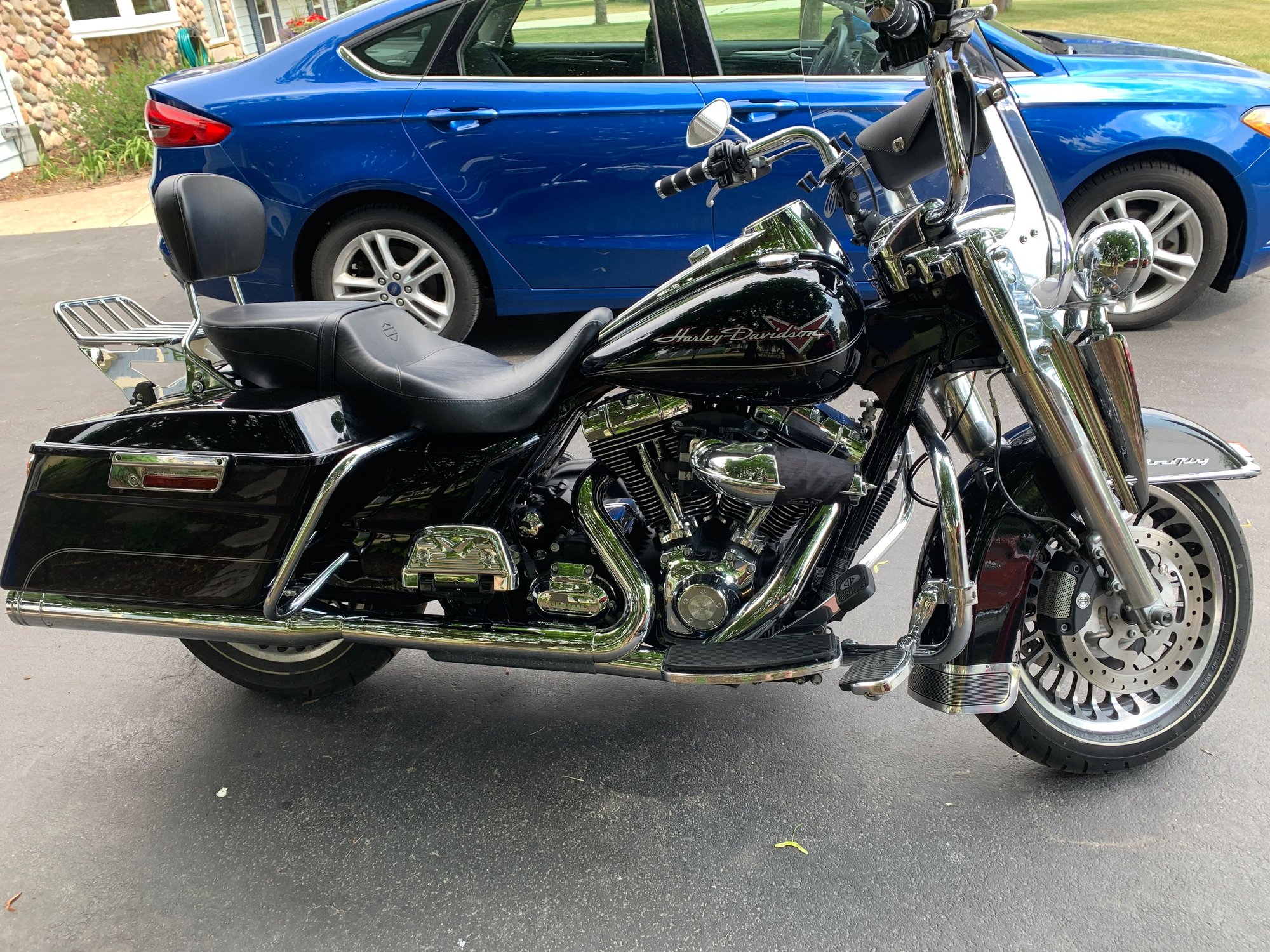

Nice bike, your salesman doesnt have a clue. You can pull the baffles out and measure them.
