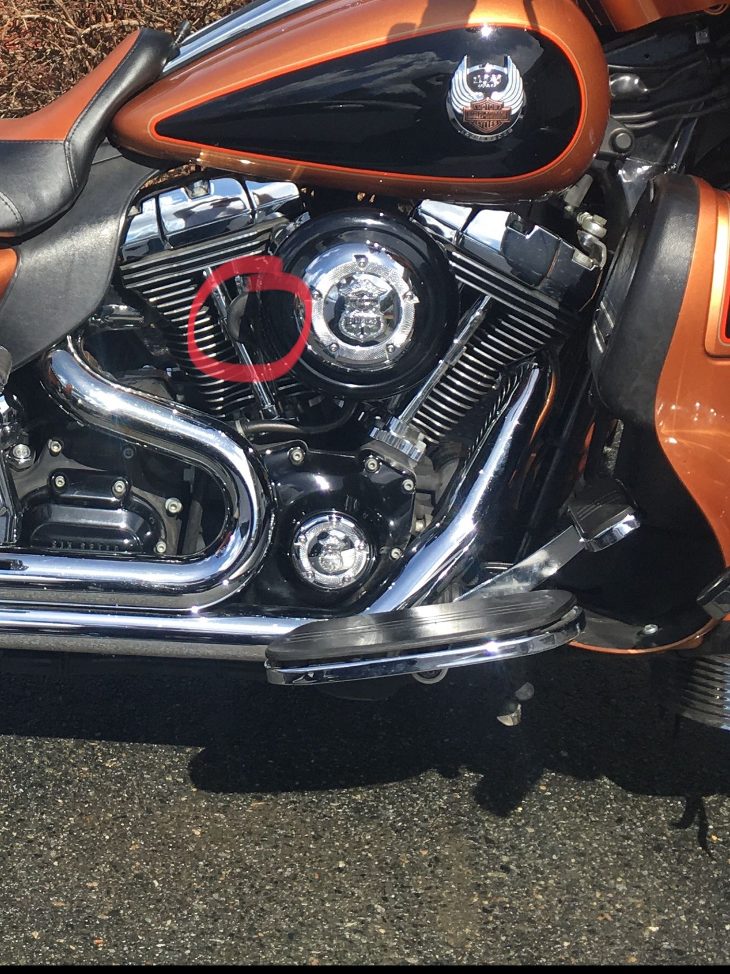

You’ll find the plug right on the left side of the AC in the rear. You can see the rubber boot covering the plug that I circled in the pic

As an add on, I had all those codes and had to replace all the pins in my connector.

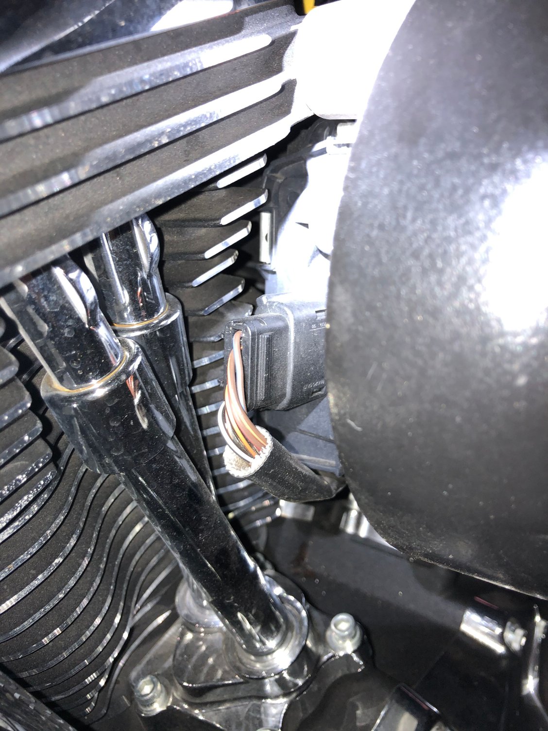

I don’t have a rubber boot but I’m assuming it is this plug?

Yes, it is the plug. I didn’t have a rubber boot either but installed it when I replaced the pins. The boot was a standard part on the 14 and later Rushmores (due to the same issue we're talking about here I presume).

thank you. I’m about three hours from home so I guess I’ll try cleaning them and see if that helps.
