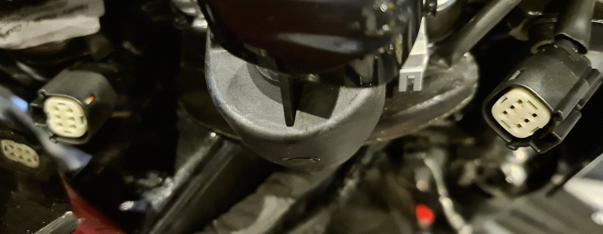

On the auxiliary panel there are 6 switch options
Two plugs are attached to it, both go into blanks as stock fit.
I use the left hand plug to connect up the HD Auxiliary lights.
Any info on what the other pre-wired options are?

Quickest way for me ( on a 4 pin) was a 12V test lamp and some experimentation
Easier than trying to trace the wiring diagram.

These connectors run to the left side of the bike in to a auxiliary connector. HD sells an harness adapter which plugs in to the Aux connector and provides a + signal output from the Aux switch on the left and right side of the ignition switch. The harness kit is around 90 bucks I just installed left and right aux switches on my ride..
