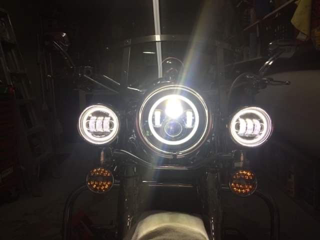

Just installed Hogworkz with halo. Went like Papa into Mama. (Plug and play). Much better than with the halogen bulb.
