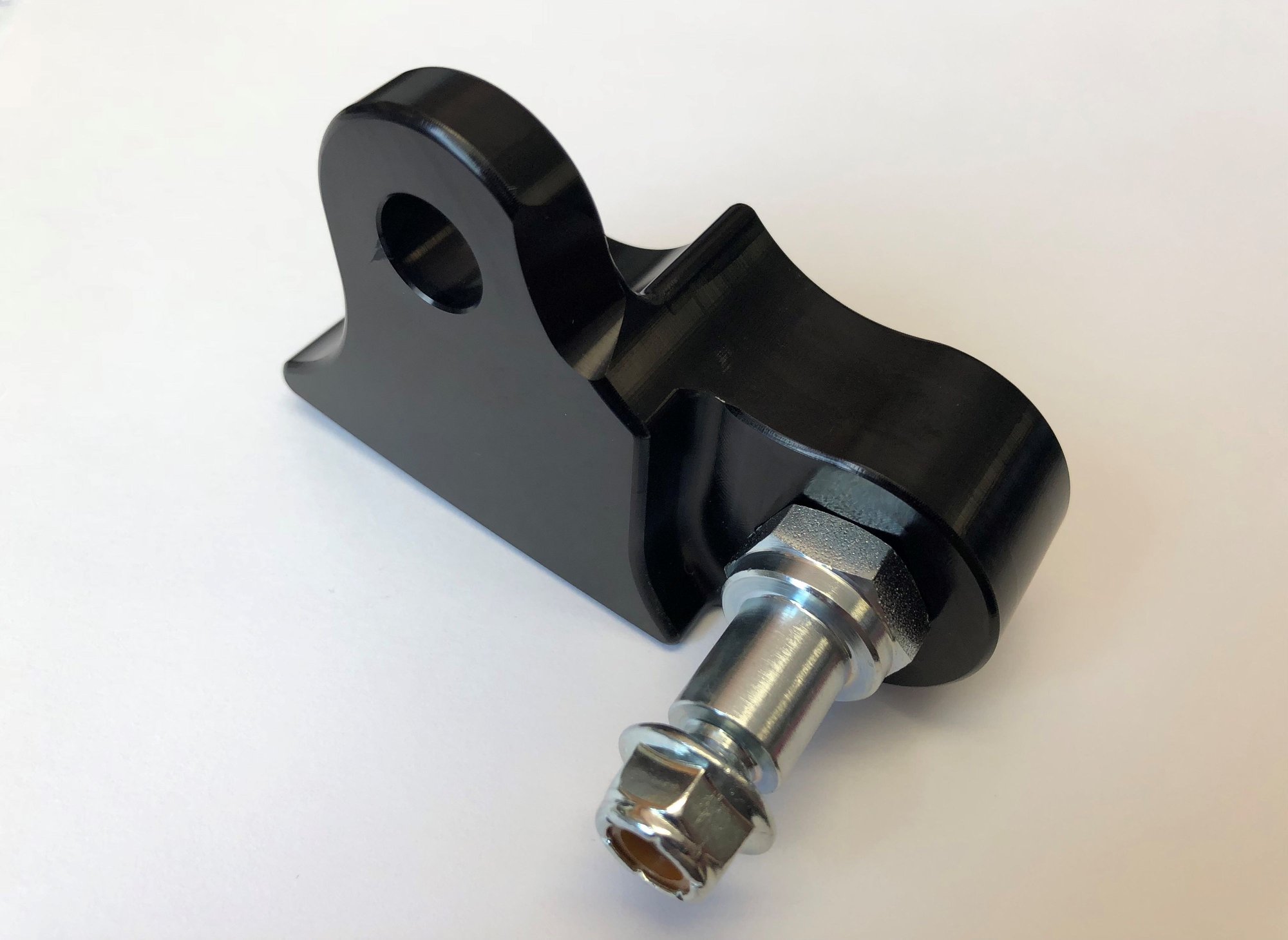

My bikes a 16 RGU (original equipment was 13" air shocks ) with Rinehart Slimline Duals (2-1-2) and I have 14" SuperShox with their 1" lowering blocks. I just checked, bike sitting on jiffy stand and I have about 3/4" clearance between belt and cross over pipe. Also, no signs on the belt or the pipe that anything has/is rubbing. Might just be easier to see if you can get a set of lowering blocks for your Ohlins.
This is the one I use
