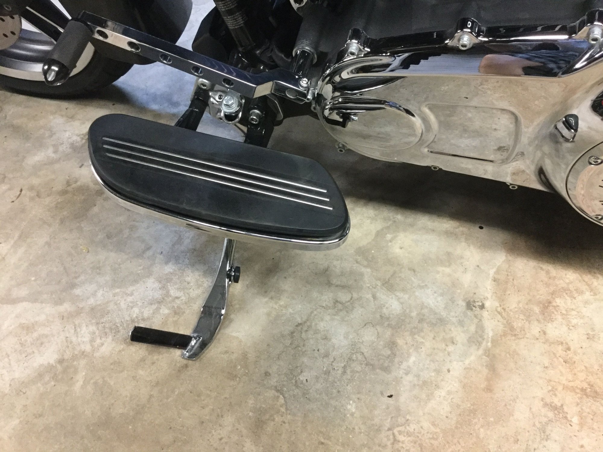

Used floorboard relocators from Covington Customs. They move floorboards 3-1/2” forward and 5/8” out. The master cylinder moves forward with them so went with 1” longer brake pedal from Softbrake. Shifter used longest one Softbrake has and their heel shift eliminator. Love the leg room they provide, now just need to decide what floorboards to get.
