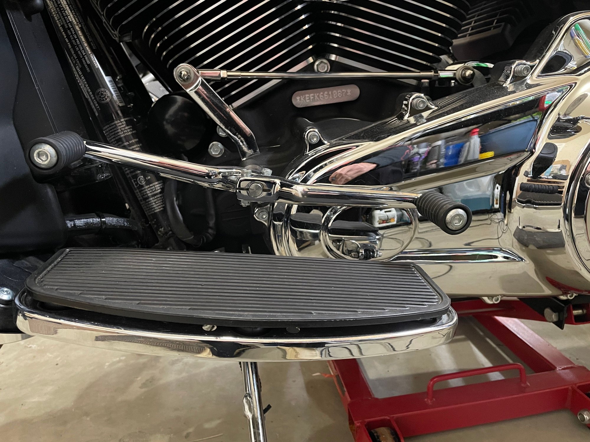

Stock '15 UC
'15 UC with TallBoys brackets and SoftBrake (cut out lowers)
'19 RGU with same TallBoys, but added 3/4" spacers (no cutting of lowers)

Thanks Hammerdown (and Tri-J )! I just saw that. So I'm guessing the 3/4" spacers are the ones that go between the frame and the TBC relocation brackets.
If so, pretty sure I have some of those in my "inventory" as well. I'll try that as I do much prefer the added 2" down (for the long legs) that the TBC brackets give me.
The way I have them now with the Kury spacers and extended footboards isn't too bad (way better than stock), but I do like the TBC relocators!
