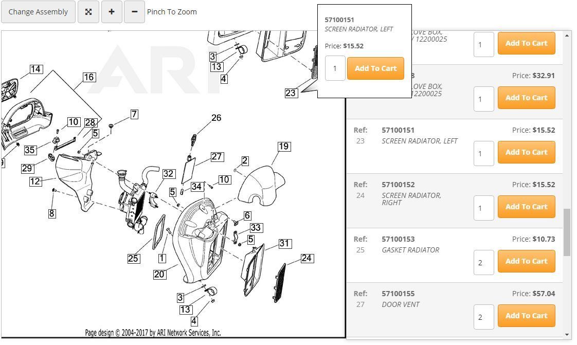

I ordered CVO screens for my Amazon lowers and a week or two ago I installed them taking out the solid plate. It really helped with the air flow to the motor and to my legs. It won't help deflect any rain but at least you'll be cooler. I'm running a 2020 RG with a Stage 3 119 kit.
Found these on AZ:
Amazon Amazon
Popped out the solid plates on my lowers and will install these when they arrive. Great suggestion! Also changed my oil, had about 3k miles since last change.

From: anacoco, la
Originally Posted by GlidinRide
Nice, I like that idea. If it ain't to much trouble to swap em out with solids come winter time. I look on AZ, you got a link? Thanks!
they aren't specific to the cvo, but to the twin cooled models. they run about $30 for the pair, which in hd dollars is really cheap. i did use a piece of double stick 3m tape on them as they are only a snap in fit, and they have been know to just pop off while riding. (i haven't had this happen, but the parts guy says it happens pretty regular.)
you're looking for item 23 and 24.
