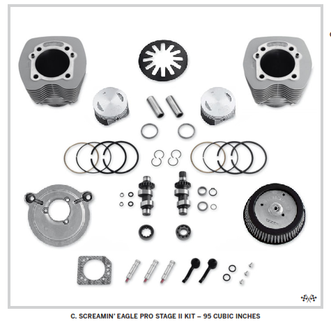

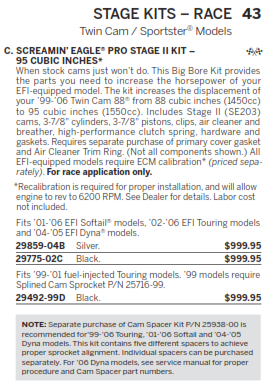

Does anyone have a build list for something like this? Surely someone else has done this build before.
Maybe something like this?
sorta, I was thinking more along the lines of part numbers
