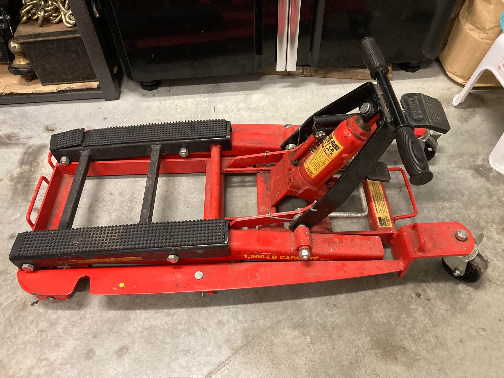

I have a Torin Black Jack. Rated for 1500 lbs and sell new for around $200. I got mine on craigslist for $40. Very stable and handles the weight of my motorcycle no problem.

I have the HF MC jack, and have no issue with it at all. When I changed both tires, I did as suggested, and put my scissor jack under it also. Mine was on the rear, not sure it really matters.
Make sure you lower the bike to the safety stops if you are going to leave it. I take mine to Cyclegear and for $25 a tire they remove old tire, mount and balance new one. No issues yet.

My HF lift is wiggly while going up on the hydraulic cylinder, but quite stable when lowered onto the locks.

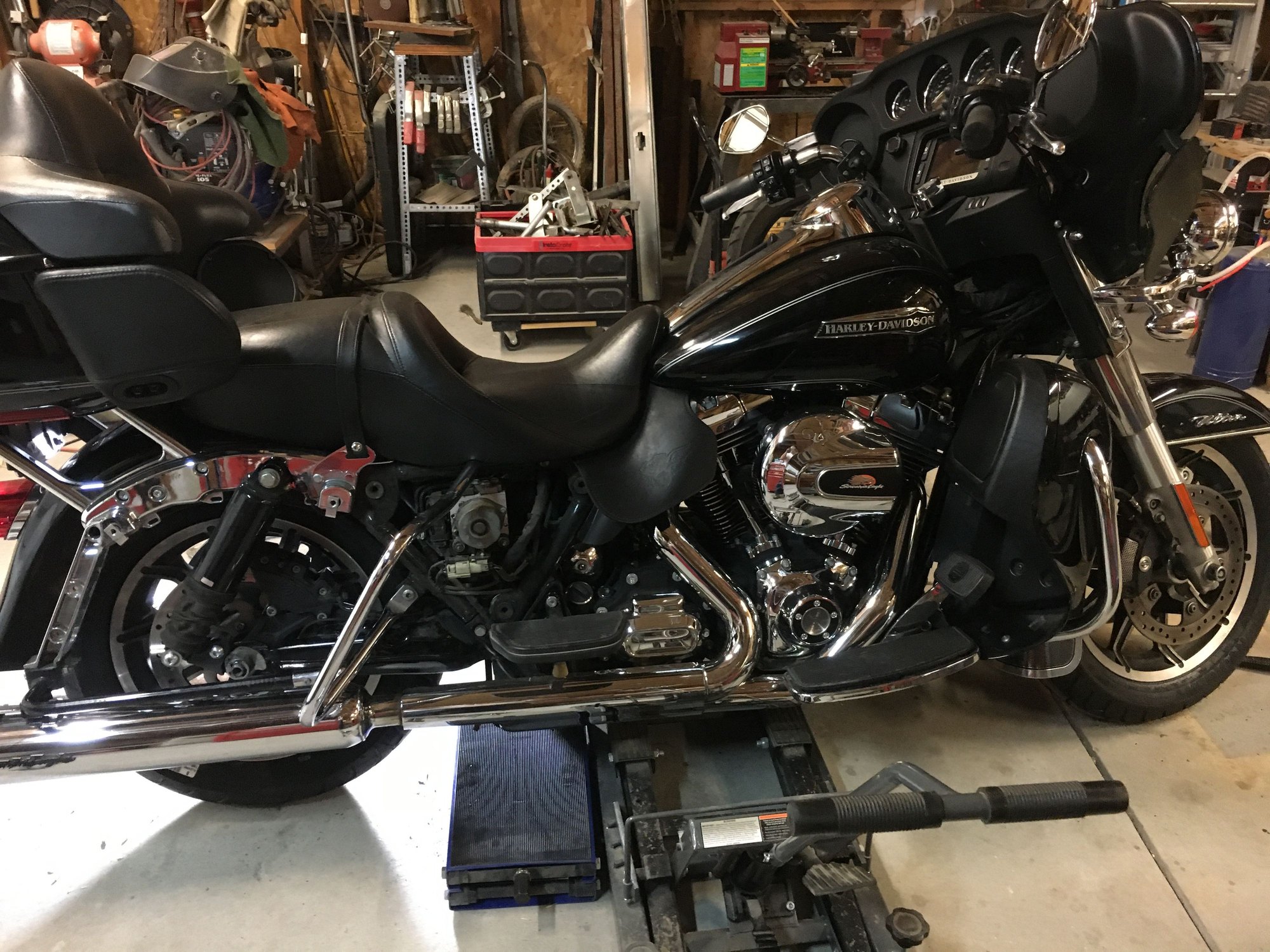

While it may be a bit different than the jack the OP queried about I've used the type ( probably the same brand ) that @MotoJockey has shown for over 25 years and have never had a problem ... Changing the front tire, changing the rear tire and changing both tires at the same time along with a fork rebuild

My jack clears the 14SGS just fine, but this is exactly how I have to get it under the 03 RKC. Pull on the throttle slightly and gentle push on the jack with my foot.
