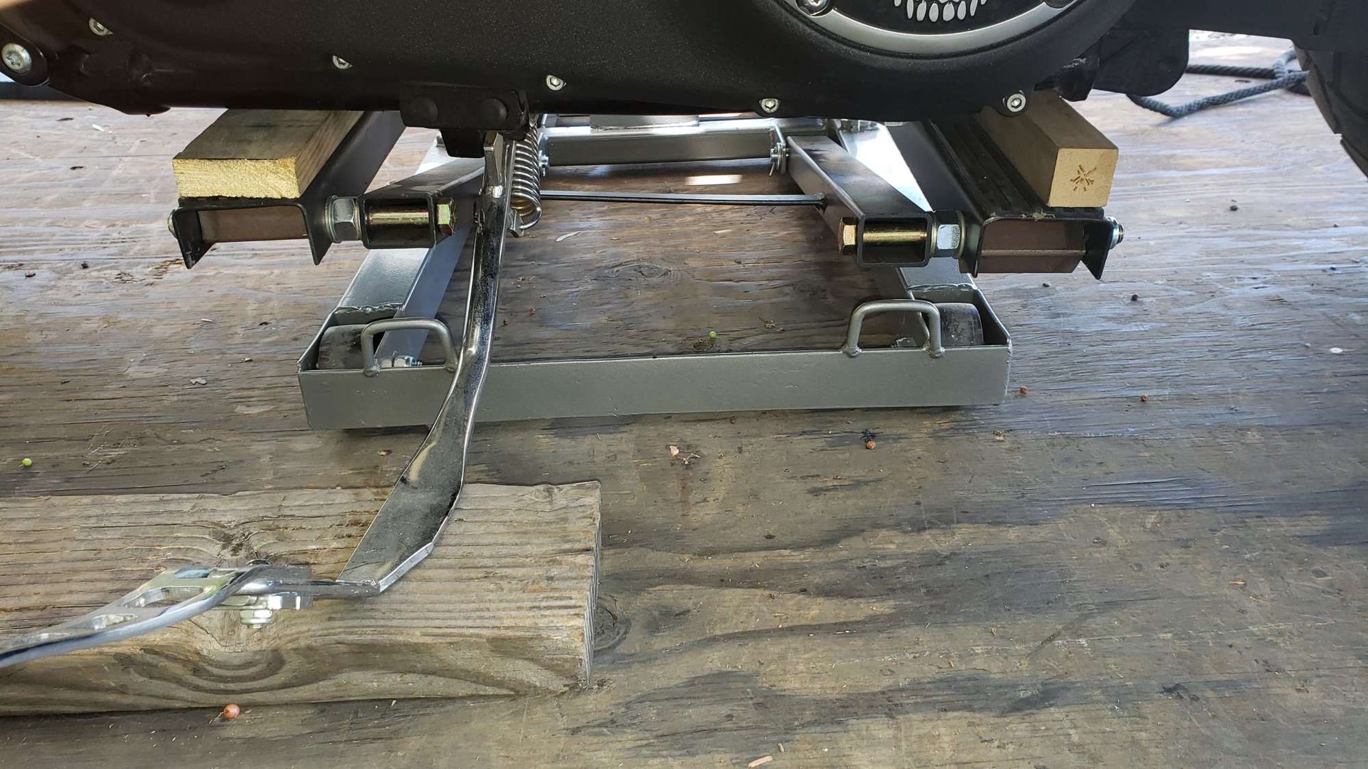

How does one jack up the bike while on the jiffy stand? Starting off raising at a tilt would be tricky. A second set of hands might be needed to steady the bike upright while the lifting starts?
While straddlimg the bike with the jiffy stand in down position, I lean a liitle to the right enough to raise the jiffy stand foot high enough to slide a piece of 2x6 under the foot. (Use a 1x1 stick in my left hand to push the 2x6 piece under the jiffystand foot) I then lean the bike to the left and let it rest on the jiffystand with the 2x6 under it. This routine raises the frame enough to allow rolling my jack completely under the frame. I slowly jack the bike up and it gently rolls to straight up vertical position supported now by the jack pads. Hope this makes sense

It's much easier to position the 2 X on the floor slightly rearward of of the jiffy stand. Upright the bike so the jiffy clears the 2 X, and then back the bike up a few inches and rest the jiffy on the 2 X. No need to position the 2 X with a stick.

I rotohammered four holes in my garage floor and set threaded anchor points flush with the floor. When I have the bike on the lift, I screw eyebolts in, then strap the bike to them, ain't going nowhere. When not in use, I put setscrews in the anchors to keep dirt & crap out. If I am working on a bike that my jack won't slide under, I just roll the bike up on a couple of pieces of 1X6 boards, jack slides under with clearance. Maybe a board under the kickstand to start with too.

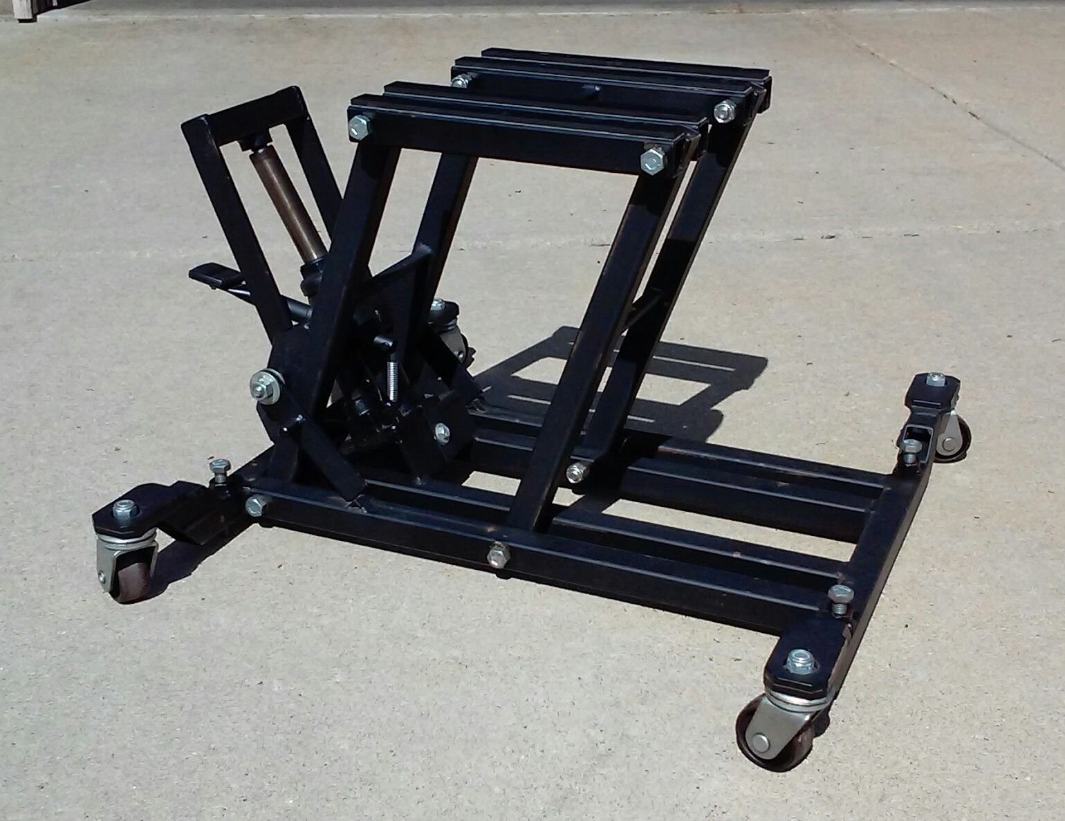

I refuse to pay someone for a well known design when I can fabricate my own for a fraction of the cost.. $80.00 in materials including the steel, 2 ton bottle, four swivel casters, grade 8 hardware and paint. Collapsed height is 4.5", raised height when locked is 18".

No, I'm not saying that. Based on inflation alone, that $80 would likely be around $130 today.
My son in law's $600 J&S jack sat in my garage for a few months, so I had the opportunity to examine it's components. I'm confident I could build an exact replica for about $200 in materials, which would be a fraction of what J&S is currently selling theirs for.
