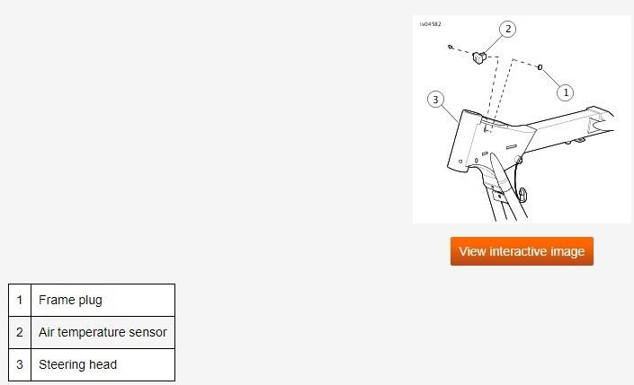

I have a 2012 EG Ultra Ltd. I too am replacing air temp gauge with oil temp gauge. Instructions say to locate connector 107 (air temp sensor). "Connect the 3-way end of the (new) harness from the kit to the mating connector at location 107." In my repair manual, connector 107 is pointing at the back of the fuel gauge, which doesn't help much. I cannot see anything that has a connector that would match up with the connector on the new harness coming from the oil temp sensor. Can you point me to where the #$%^&! air temp sensor is located? TIA
Never mind, located it, as pictured. The white plastic block is pretty well hidden inside a black plastic housing.
