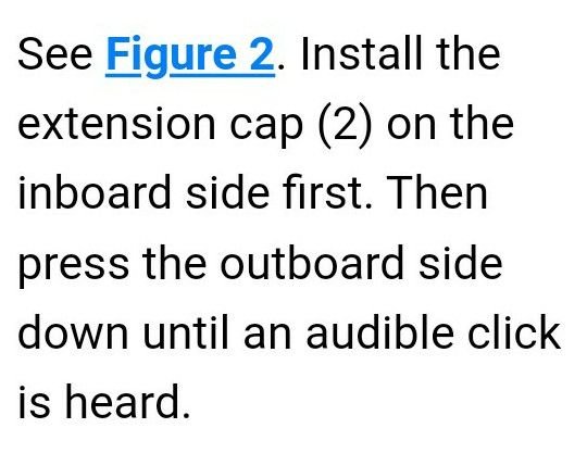

Has anyone replaced their stock turn signal switches with the longer extension cap ones? I replaced mine today, turn signals work perfect but then noticed i am unable to push the "interior" buttons which is voice command on the left and information on the right.
I don't use voice commands and hardly ever use the information function so it's not a huge deal. But I am guessing since the extension caps are longer, you lose the ability to "push in" and use those functions? Make sense??

Did you install the inboard side first?
