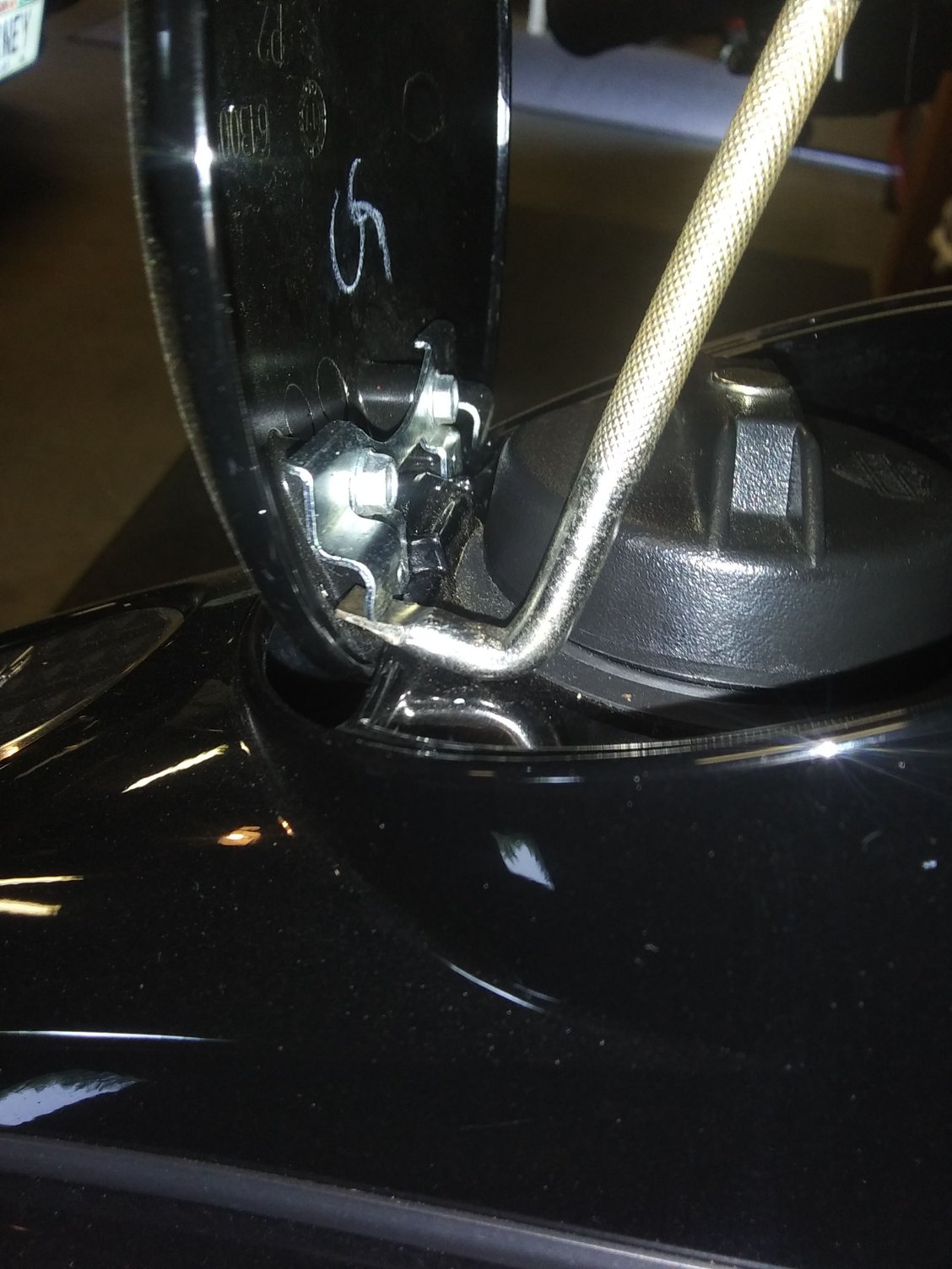

My buddies bike was doing that and we lubed the hinges and took a 90* flat head and bent out the lips that push the door open to give it more pressure. It worked good and hasn't been a issues again.

The spring that pops it up gets weak over time. You can bend the tabs out some and give it more spring to pop up. I assume that's what you're talking about.

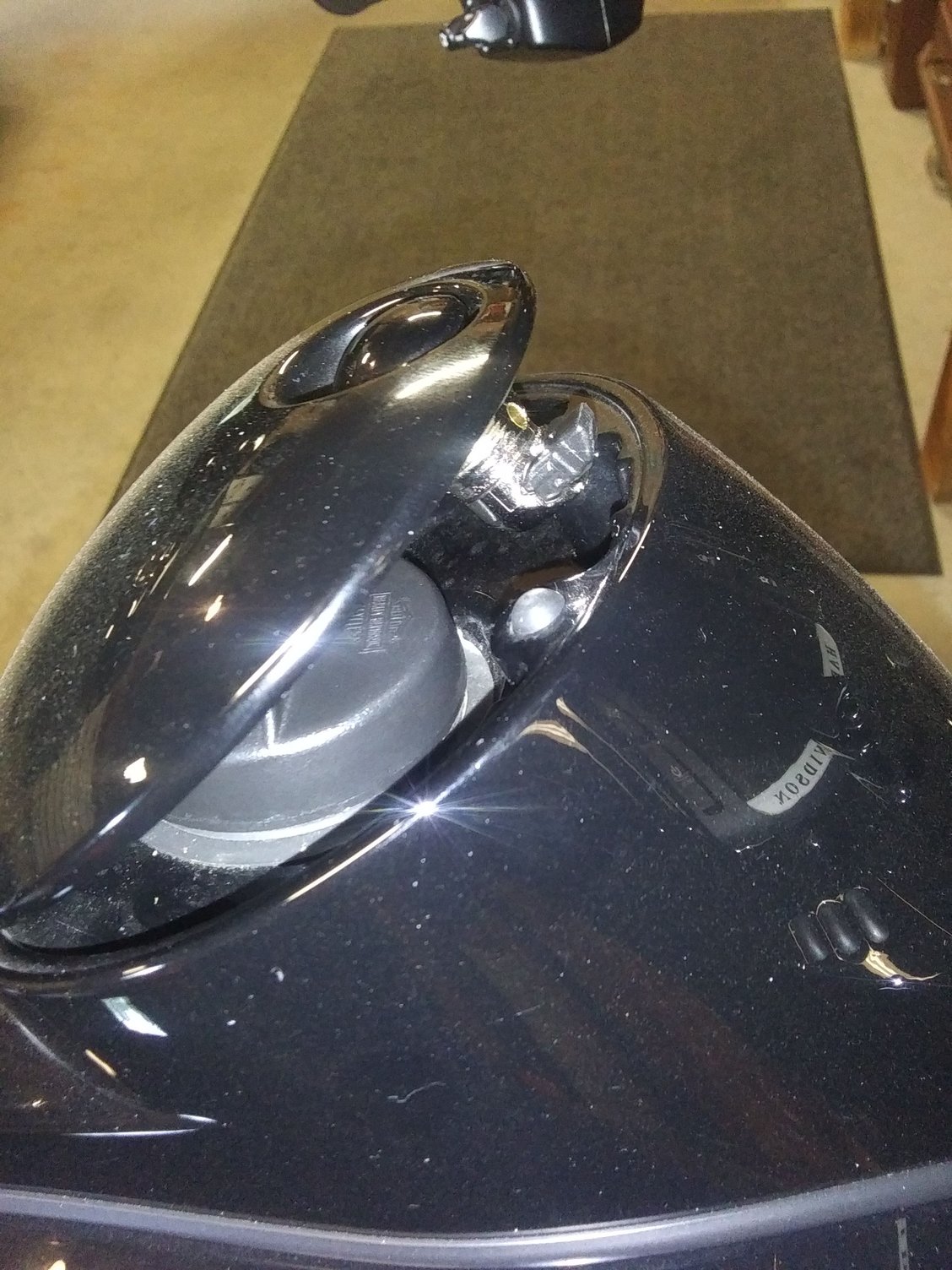

Thanks for the tips guys! Mine has been hit and miss lately (mostly miss). When it did pop open, it was barely 1/4". A 90° flathead made it easy to get behind the tabs and give them a gentle tweaking.
I'm happy to report it now pops open about an inch, first time, every time.
