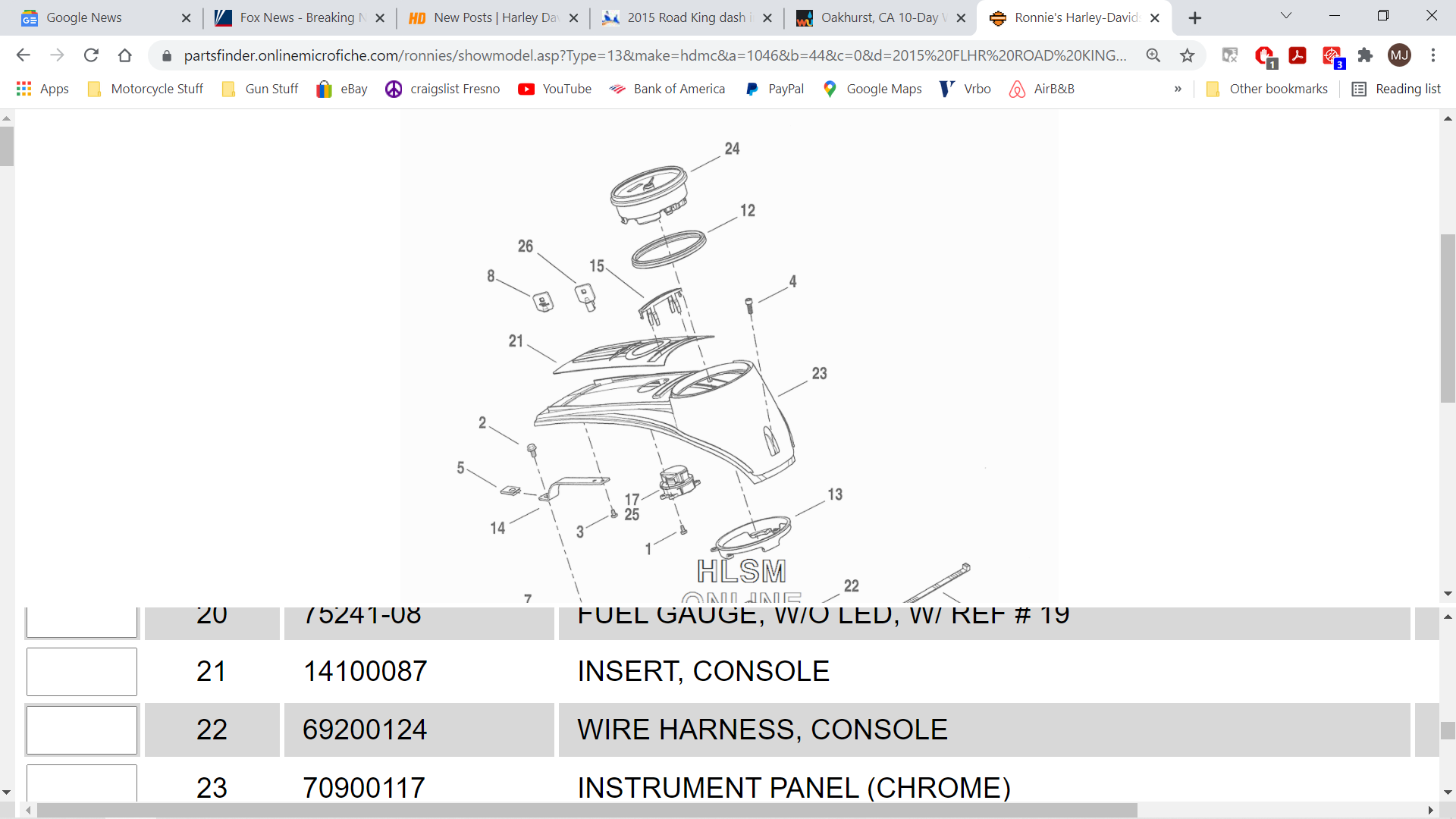

Perhaps the parts finder below will help you confirm part number.
If it is part 14100087 and if the name is insert,console then it looks to be about $53 USA dollars.

Check Ronnie's. Item #21. $52.49 for just the insert.

^ Yup, that's the part he needs. I replaced one on my '13 Road King. Peel the old one off, stick the new one on after removing any adhesive residue.

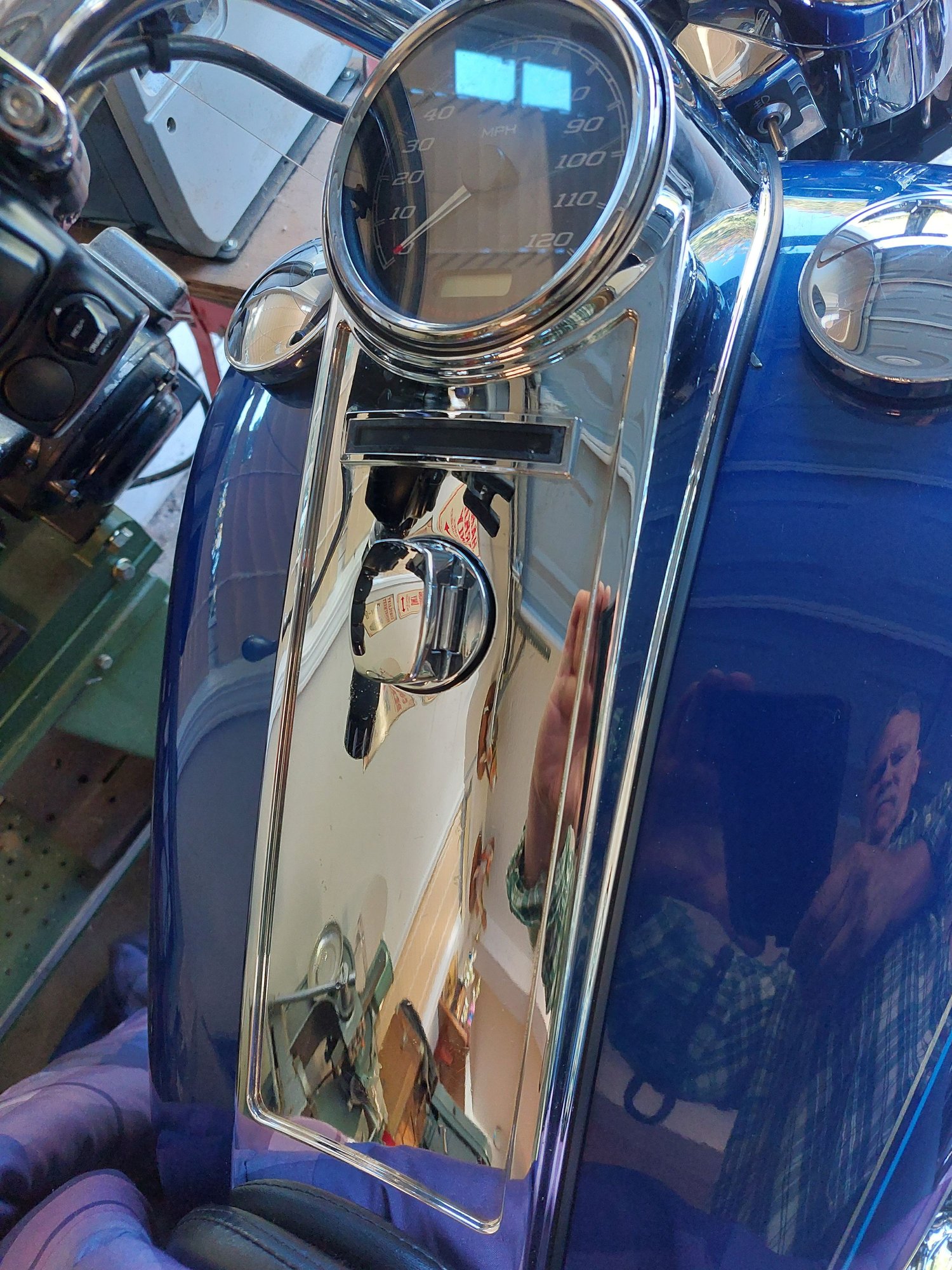

This is what it looks like without the insert. You can rough out the chrome and prime/paint, dechrome and powdercoat or find a nice hardwood veneer...

That looks nice if all it requires is removal & clean-up

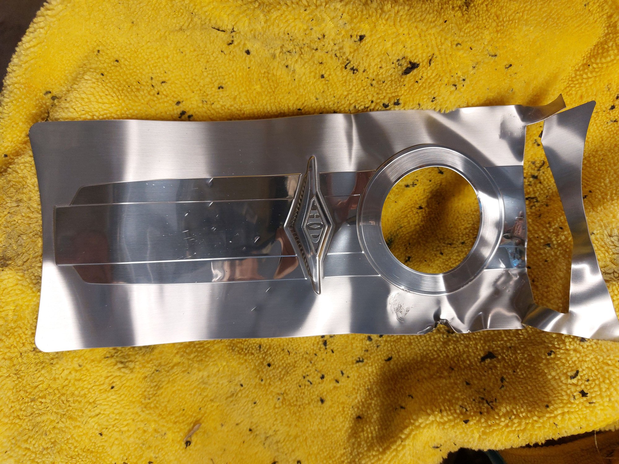

As another follow up, thought I'd let you all know that I heard from Ronnies and it appears my new insert will be on the way shortly.

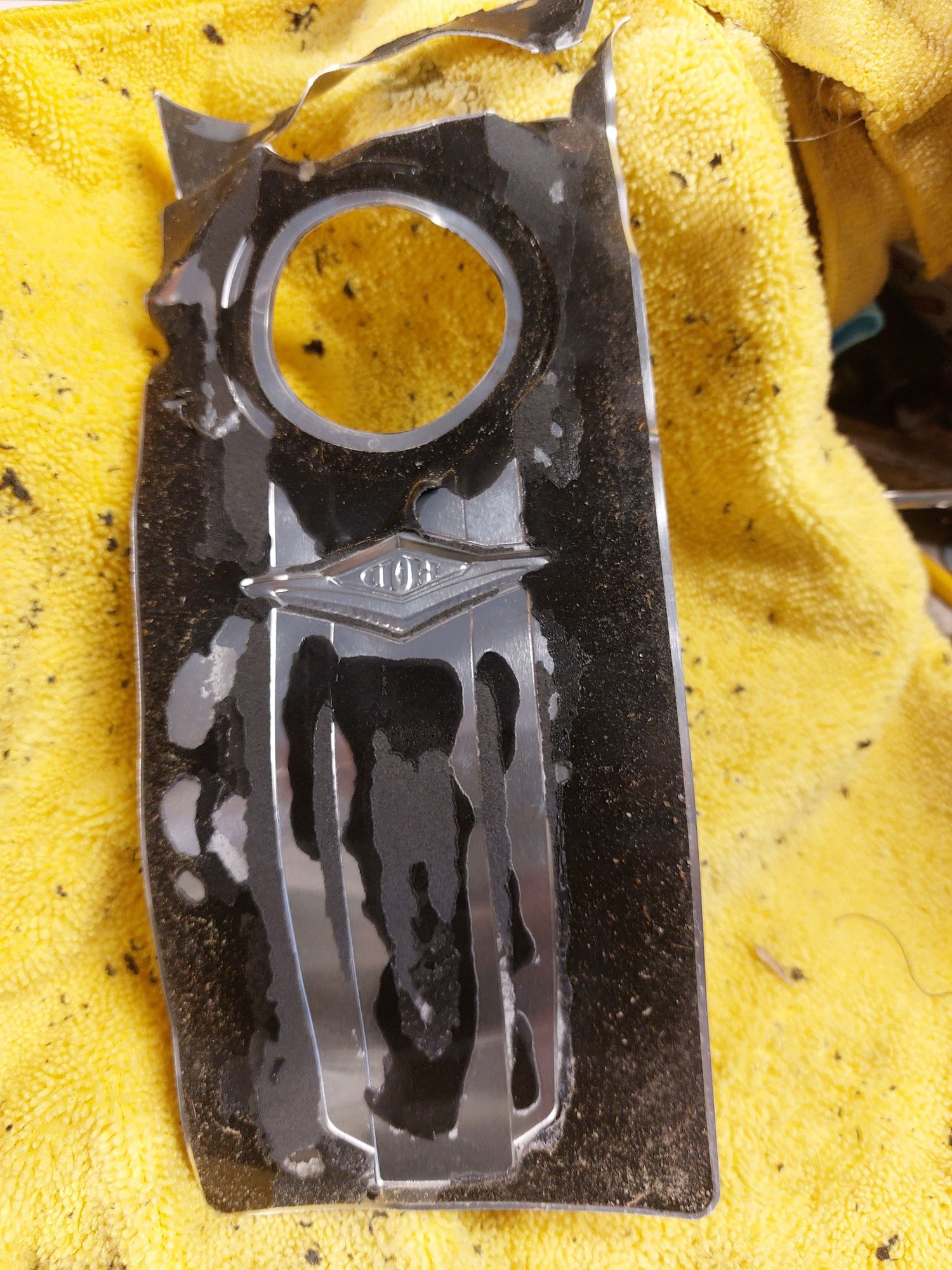

In the mean time, I pulled off the dinged one. It comes off pretty easily. I started with a small screwdriver, very small, using a large plastic zip tie to protect the chrome. I slid it under the screwdriver as I gently worked up the top right corner. Once up, I could pull it with my fingers, and then used a pair of pliers to peel it back.
The tape holding this on is pretty robust. I used goof off not wanting anything stronger that would harm the paint. Took a long while with cloth and fingernail to get the tape off. Still have to go back and clean it up some more.
The factory chrome under the stamped aluminum insert is really spectacular. I am almost considering some sort of emblem to put on there.
