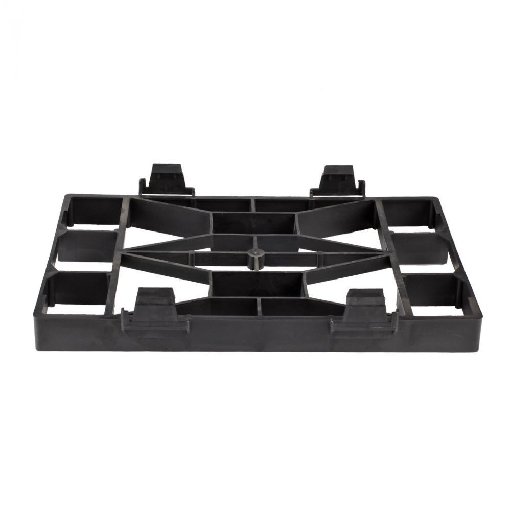

I found this chart on an Energizer Powersports battery ad. There does seem to be a height difference, but I don't know why. This chart mentions a "17mm height adapter" and I have no idea what that means....???
All else is the same between the two according to the chart.... I'd measure the OEM battery and pick the one nearest in size..
Some batteries come with a plastic "spacer" to sit the battery on so they are a certain height, if they have to be "X" inches tall, for everything to fit and sit tight, or whatever. Got one with a battery I bought for something... not much to them, just a plastic base it sits on.
this is an example, the one that came with mine was not even this "elaborate"
