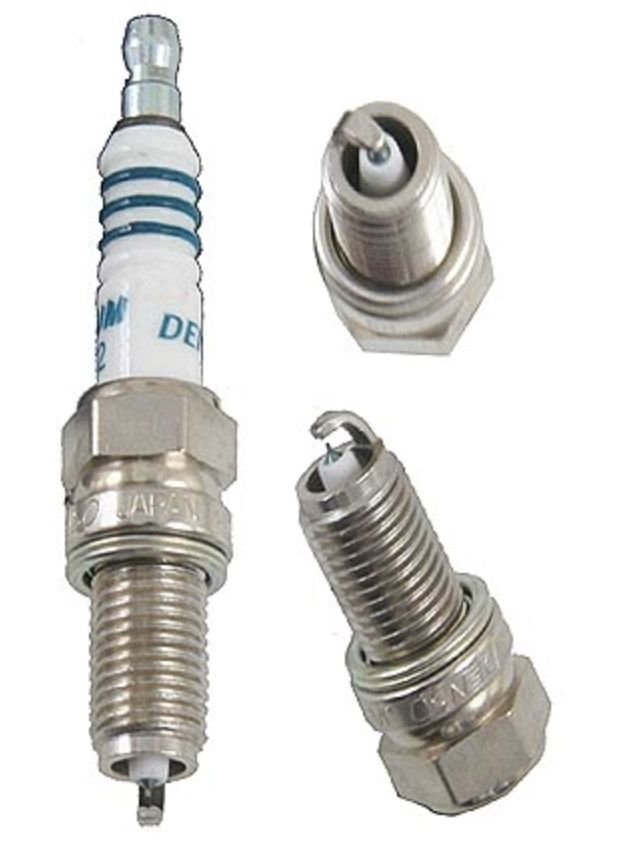

I ran Denso IXU 22’s in my 95” ‘01 carbed FXD. Started and idled better than stockers. Can’t say it ran better on the road but the motor was strong. I haven’t attempted to use them I a EFI motor.
