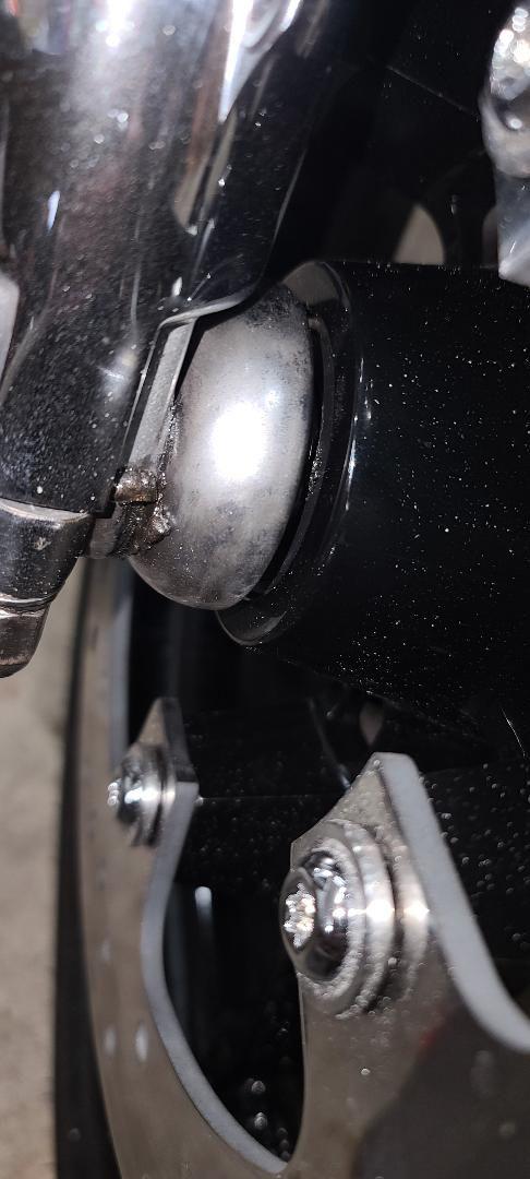

I upgraded the front wheel with a 21inch Reinforcer with rotors and bearings installed and a Shinko tire(I will be ordering a Mich later) package deal for my 2009 SG with ABS. Prior to the install I took the bike to the stealer to have the ABS flush service because I installed new brake lines and EBC pads. Anywho, I removed the old rim/tire and installed the wheel on the bike and made sure the tire was in the correct rotation. Torque up and went for a test ride. When I start to apply the front brakes it wants to stop but there is some shaking going on down there that I can feel thru the bars. I rechecked all the bolts and calibers all was tight. There is a small space between the stock right spacer and the wheel which i ordered some tapered spacers but the wheel is solid with no looseness on the ground or on the lift. the ABS wheel sensor is where it should be per the service manual. ABS light goes off when I take off and does not seem to malfunction. Has anyone experienced this issue and How was it resolved. Thanks

Right off the bat I would say there should not be a space between the spacer and the wheel, everything should be as it was before you changed things out, pics would help.

If spacer has a lip on the inside where it contacts the inner spacer , the small gap will be there.
