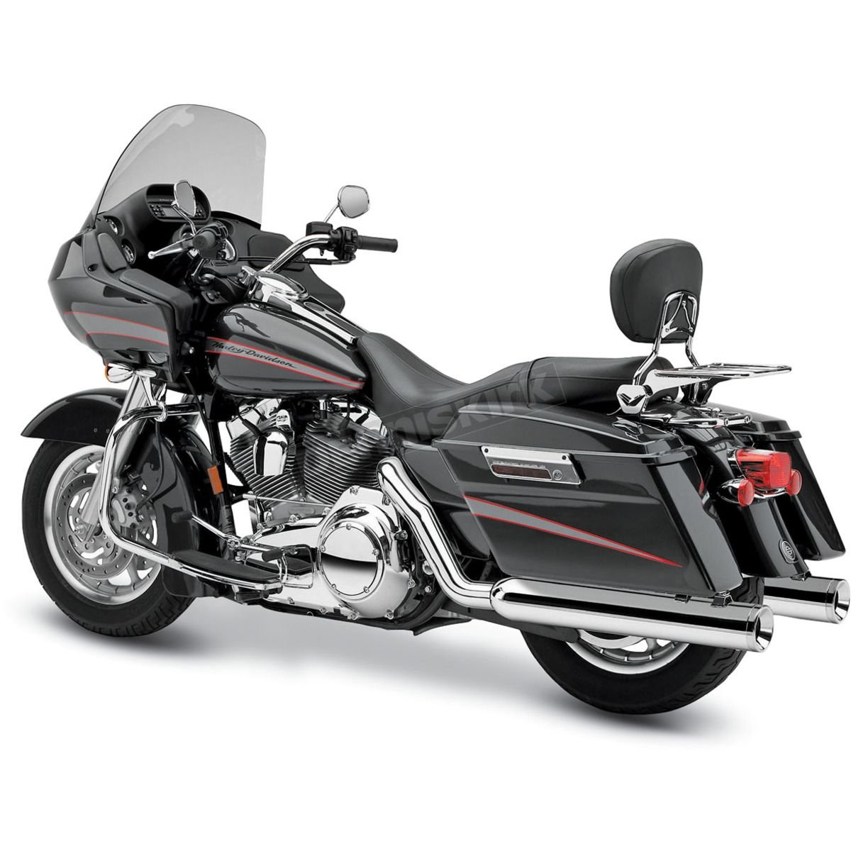

Know your duels and duals!
True duel...
True duals....
