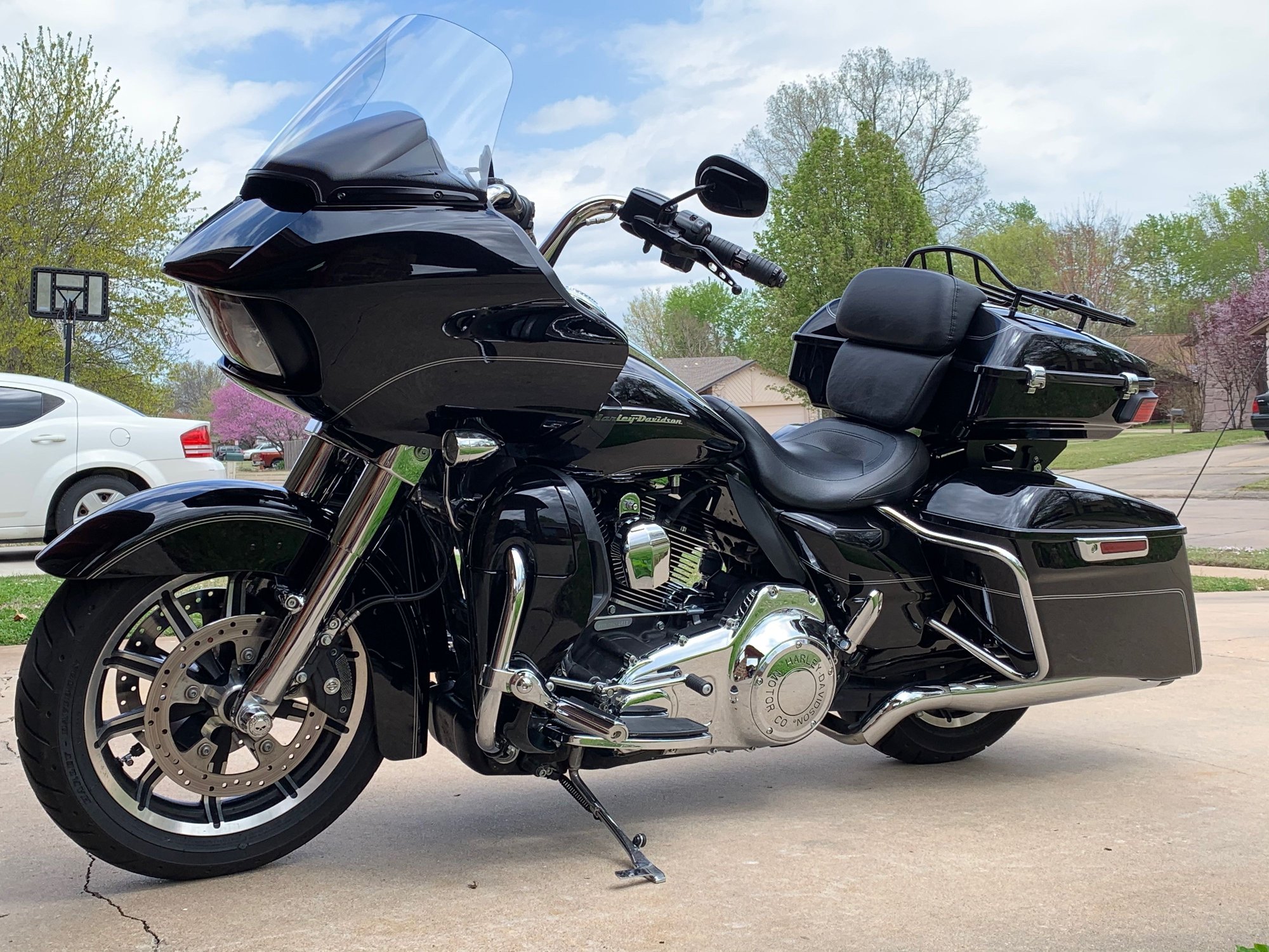

King tour pak setup for solo on SGS.

I sometimes run the chopped TP on mine so can't speak with experience on the King TP but I'll agree with Goose. I removed the wrap around backrest altogether and plugged the holes since I was repainting the pack. I run my usual rider backrest and remove the pack if I have overnight or extended stay. Seems I deleted the pic's of mine but the pic Joee Joee posted should give you a perfect example of what you'll be dealing with.

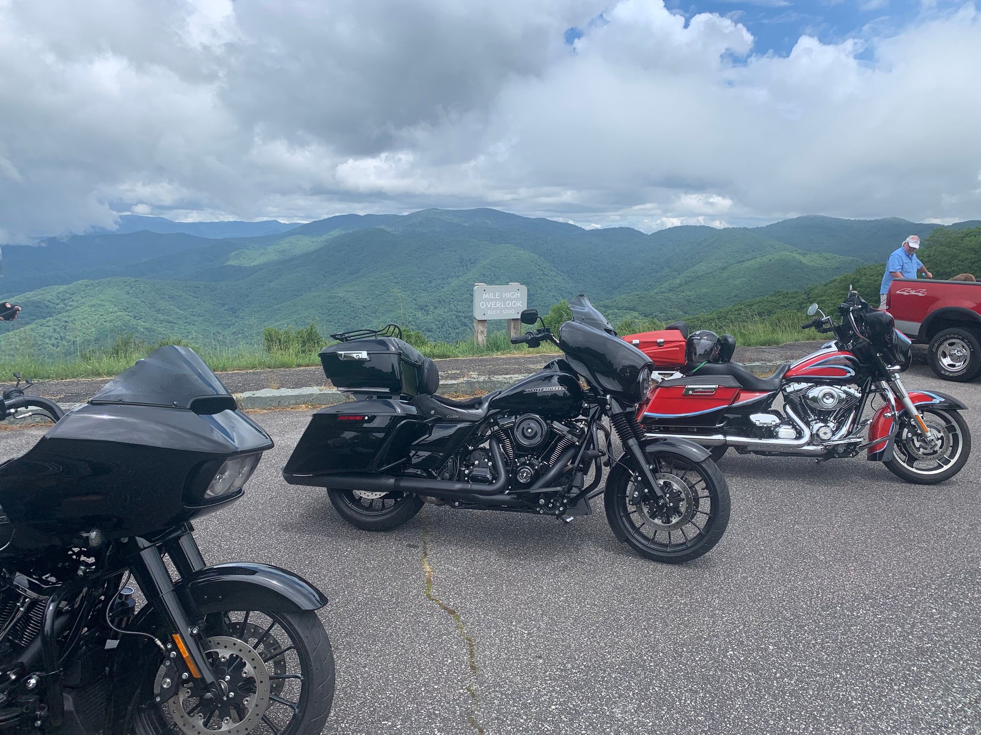

I have a King and a Chopped tour pack, I will say the stock Chopped's pad was like a little rock in between my shoulder blades, until I had it modified locally (adding more padding and reshaping it). Now I really like it... Chopped is for 1-up, King is just for 2-up (for me)
If you're wanting to get rid of the wrap around look/feel of the King's wrap around, you might check out C&C Motorcycle Seat's "Banana Trunk Pads" in case it interest you...
I don't know what they look like/feel like on a King, but I may would have gone that way, if I had known about them before hand, for my Chopped.
https://ccseats.com/sissy-bar-pads-banana-trunk-pads/
This is a Chopped, though in 1-up..
When I had the back pad modified, I also did the lower flap part too, adding 2 inches of padding... for a King i would've had them make it a bit longer (to hide wires)
The lids are the same on a Chopped and a King (2014 & up), but they are drilled different for a wrap around or a chopped pad, the real difference is the King's bottom/tub is 3" taller than a Chopped... so imagine that pad sitting 3" higher

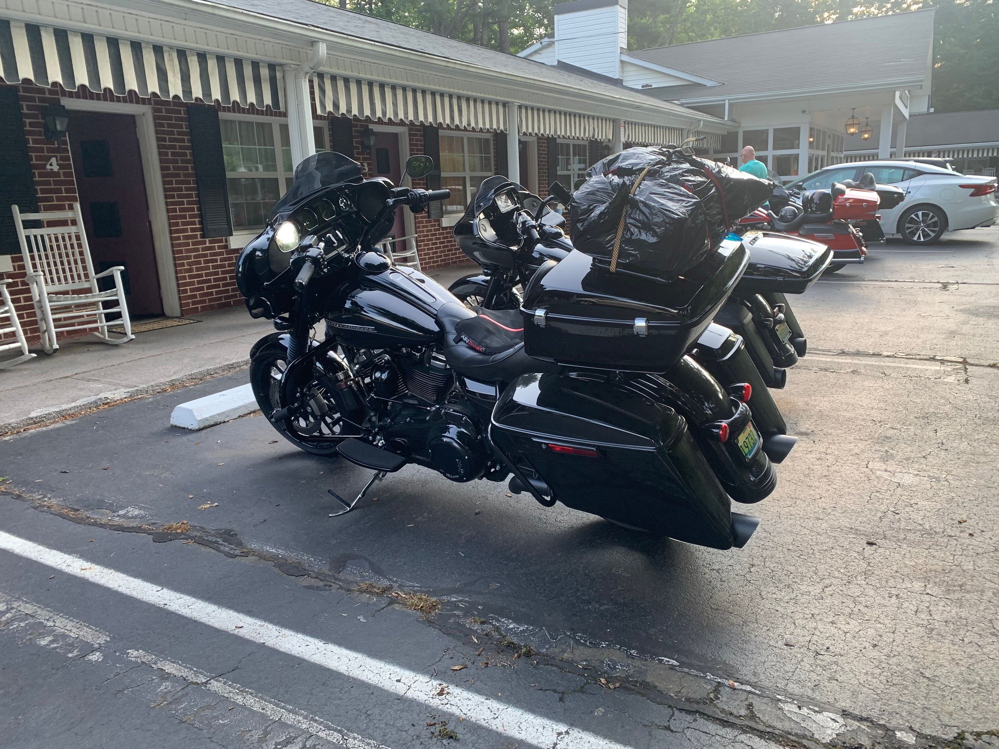

King Tour Pack for my 2019 SGS
