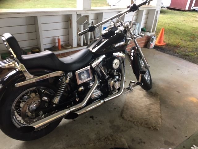

I had to drive 480 miles (to Atlanta,) last September to find it, but the '02 Low Rider below had just 22,000 miles with nothing more than Stage 1 mods. Lots of cosmetic / ergonomic upgrades and absolutely flawless black factory paint. Lady owner.
(I specifically searched for an '00 to '02 carbed motorcycle for the reasons stated above for a couple of months before I stumbled across this one.)
