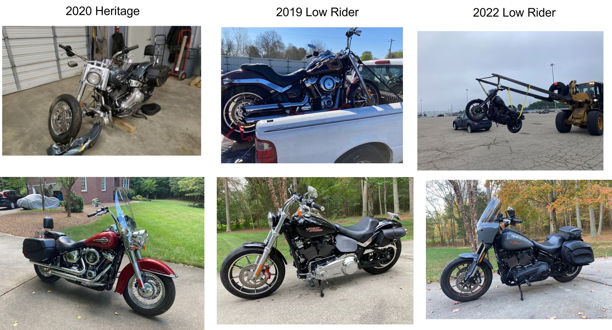

In the last couple years, I've repaired a few Copart salvage H-Ds. Always for experience and pleasure, not to make money. I keep them for a year or so to enjoy and then move on to the next thing. I would not call it a crap title. It is a rebuilt title and it is not the same as a car where you can easily hide damage. Mine sold at around 60% of a clean title. I maybe made a couple hundred on each bike and probably came out to around $2 / hour for my labor .
I found around 70% of buyers are afraid of a rebuilt title, but there are 30% that know how to evaluate damage / repairs and plan to hold onto the bike. I avoid frame and motor mount damage as its difficult to repair and scares all buyers. I would look to have the frame straightened. I would not part out as I don't have the time, patience to deal with part buyers and eBay fees. You missed a showstopper when you bought it. Don't feel bad about it. We've all made miscalculations and learned from them. Consider it tuition. Good luck to you.
