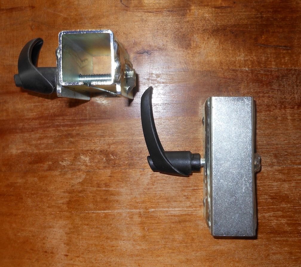

Just got the block spacers today from Rabaconda... can't complain about their customer service....
Originally Posted by LQQK_OUT
Did the threaded handle align properly?
Yes, the threaded handled lined up well. It fits straight through the body to the threads, and screws in easily...
The welds look like silver peanut butter , but everything is lined up....
