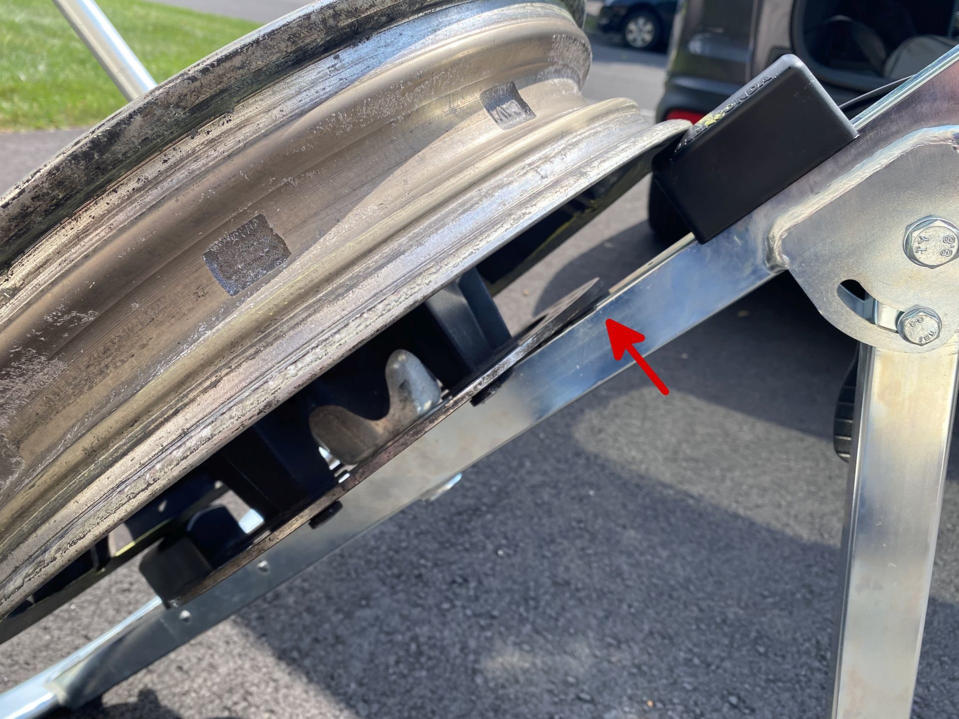

Originally Posted by Goose_NC
Photos of your issue and rim would help.

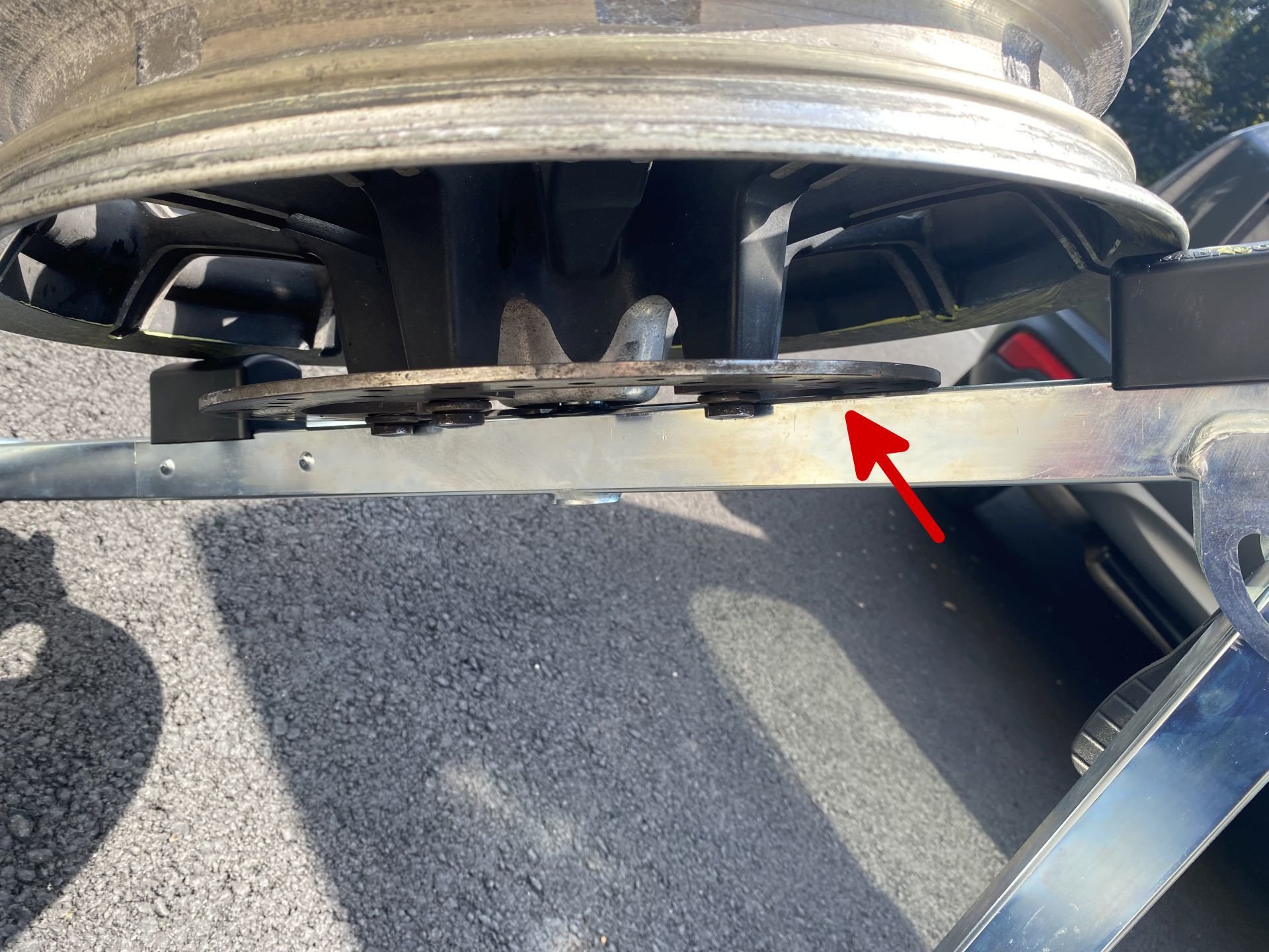

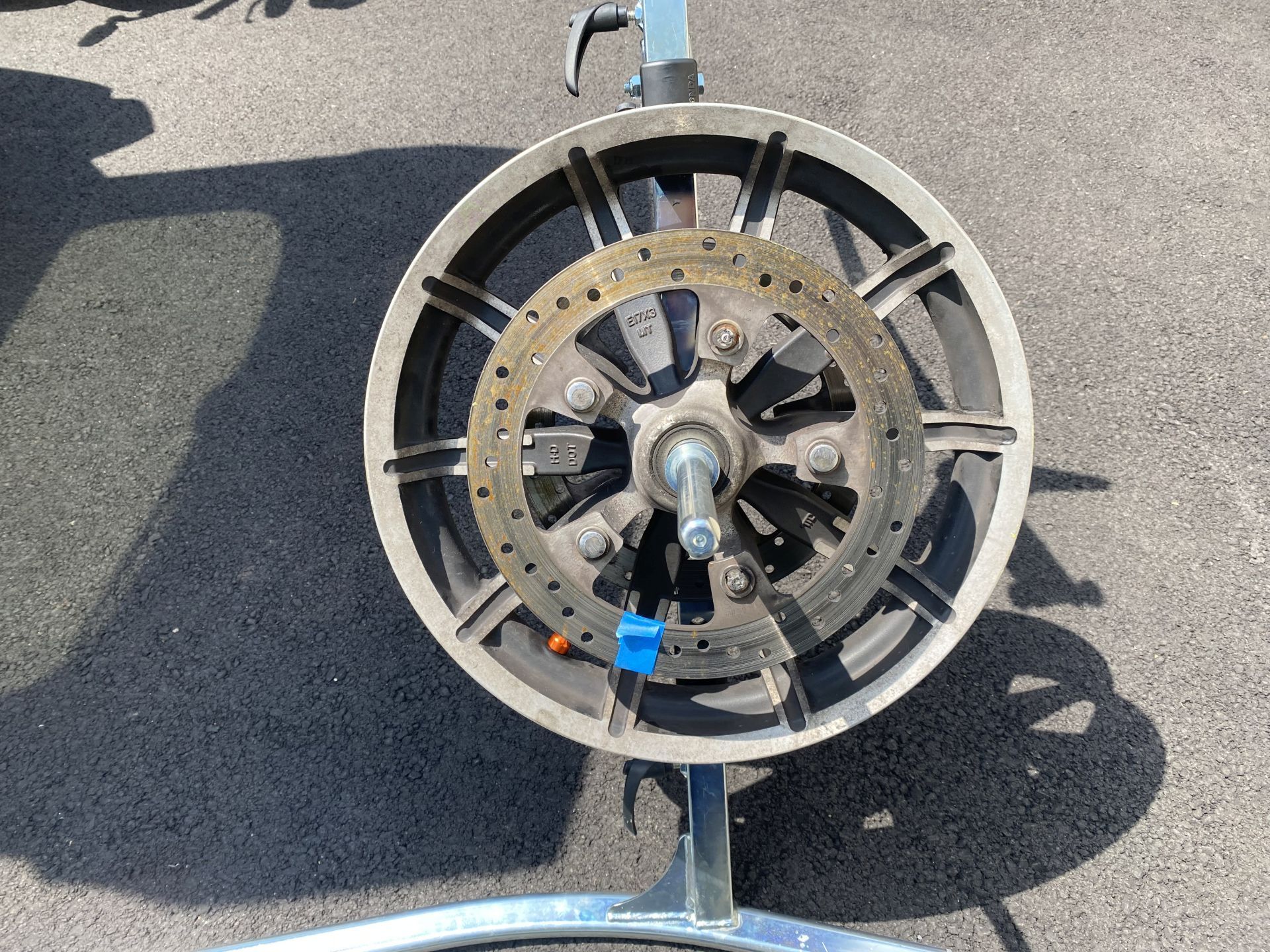

Here you go.
17" HD rim with spoke mount rotors on a Rabaconda manual tire machine. The painters tape was just to mark the abs side. Yes, I know I could figure this out via the color of the bearing.
Notice how the spoke mount rotor is contacting the frame of the Rabaconda.
Another point of view of the spoke mount rotor contacting the frame of the Rabaconda. This particular wheel also had chrome caps on the floating rotor fasteners.

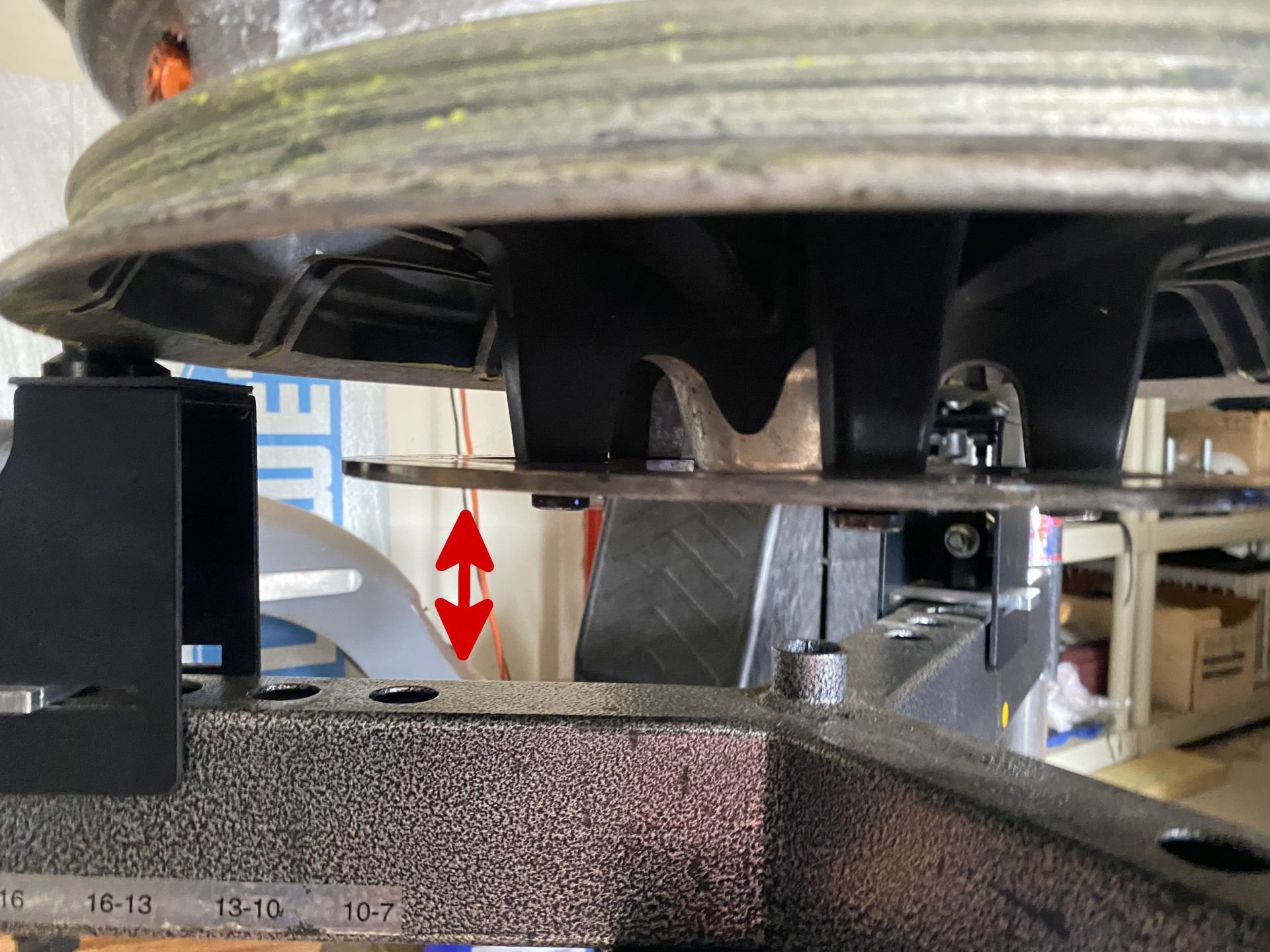

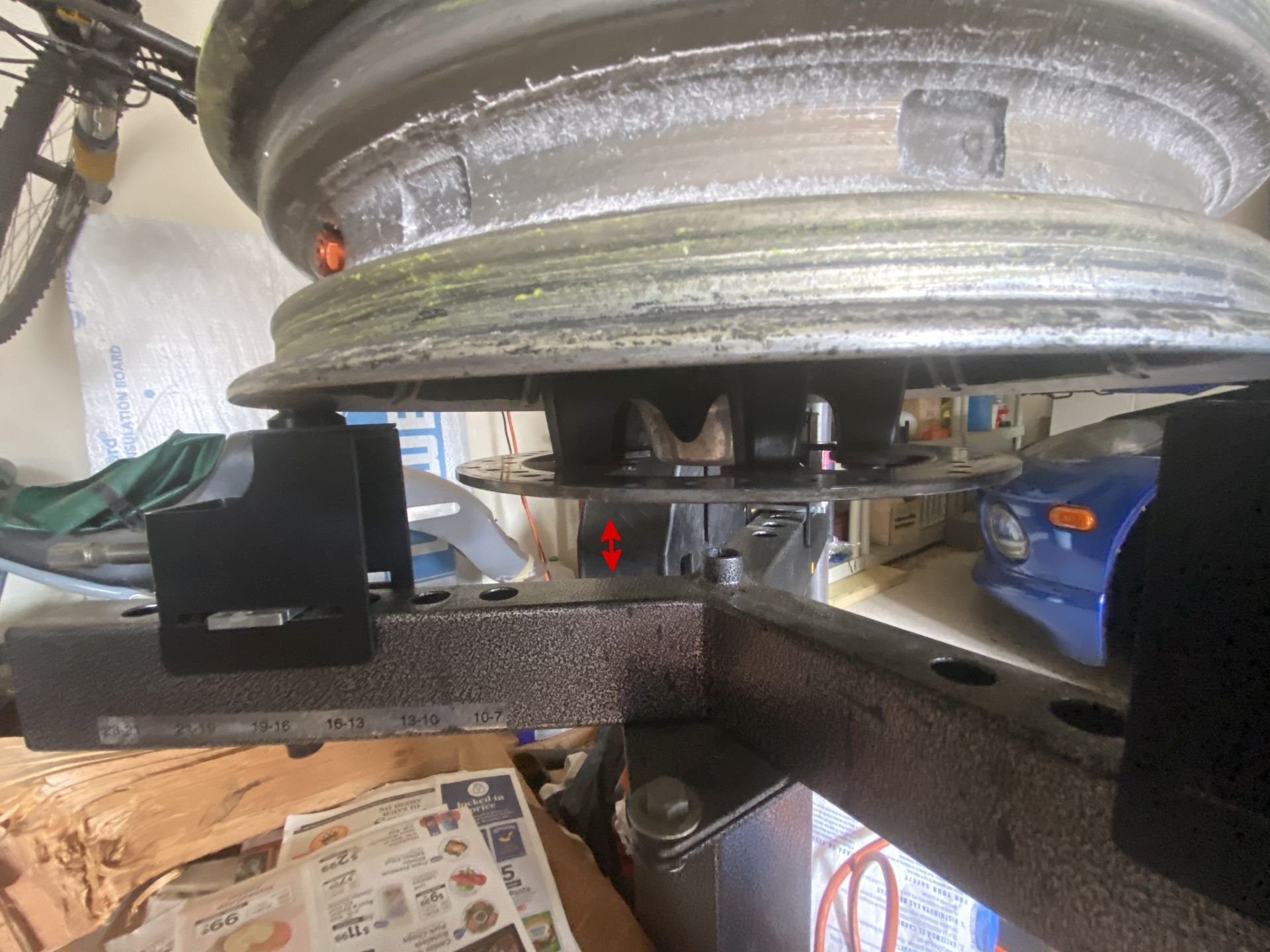

17" HD rim with spoke mount rotors on a No-Mar Jr Pro manual tire machine. Plenty of room. No contact.
Another point of view of a spoke mount rotor on a No-Mar machine.

Ahhh...that's an issue. But it seems the extended blocks will resolve that.

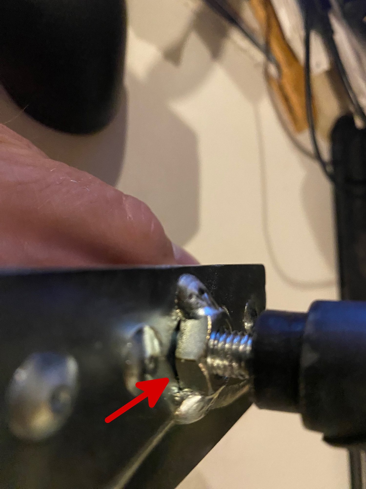

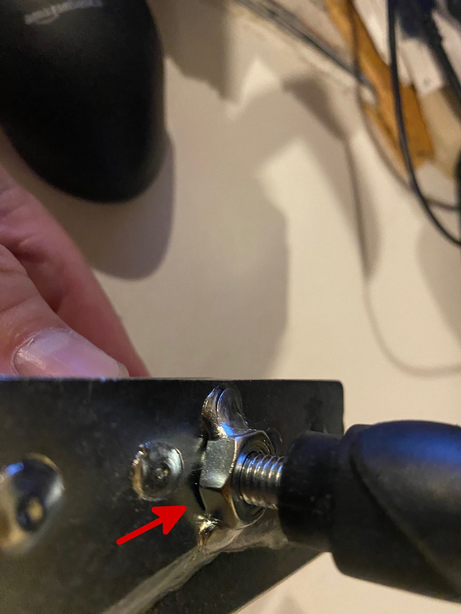

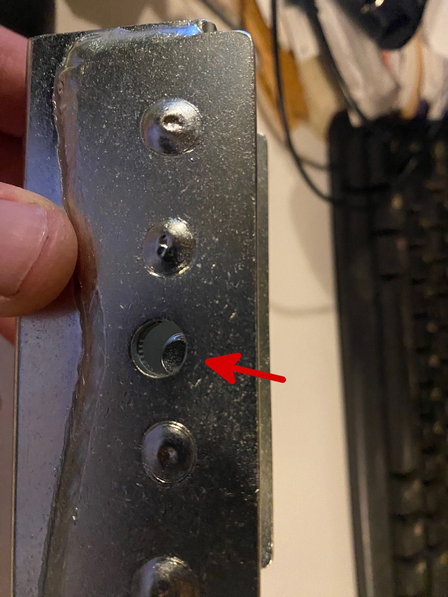

Looks like they sent me the exact same spacer blocks. No height adjustment. It's impressive they got the spacer blocks to me so quickly, but unfortunately I'm not very impressed with these blocks.
1. I'm guessing they made a mistake and sent me 2 boxes of blocks and each box contains 2 blocks. So they sent me a total of (4) spacer blocks.
2. The quality of the Rabaconda machine and the welds seems very good to me. Unfortunately, these spacer blocks look like they had the low man on the totem pole manufacture them. Of the (4) blocks I received, only one seems to have the threaded handle align properly. A huge disappointment. I'll widen the hole with a dremel.
The spacer block.
The threaded rod/handle does not align with the hole.
Check out the weld on the nut. The nut isn't flat on the steel, hence the alignment is off.
Here is a different spacer block.
Nut doesn't sit flat on this one.
