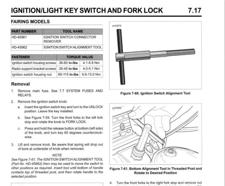

Do yourself a favor. Invest in one of these. You will see a lot of videos, home made contraptions suggested, screwdrivers etc. Not worth the hassle. Save your hair and blood pressure. This tool makes it drop dead simple and easy, so you can live your life.
XiTuanYuan Motorcycle Ignition Switch Alignment Tool 943 Compatible for Harley Touring Models 2003-2013 https://a.co/d/hAnKaCv

Take it apart - very simple. More than likely it's still out of alignment.
Note: the video below is good, but he's wrong on where the wave washer goes. Just pay attention when you take it apart. Pretty easy.

I use a short piece of 1/4” copper pipe smashed about 2” and bent a 90 deg handel at other end. Used it many times. Can’t take credit for it. Saw it on this firum many years ago
if out of alignment just stick it in and turn until it unlocks

I made the same tool 10 years ago and have used it all these years without fail. Good tech tip.

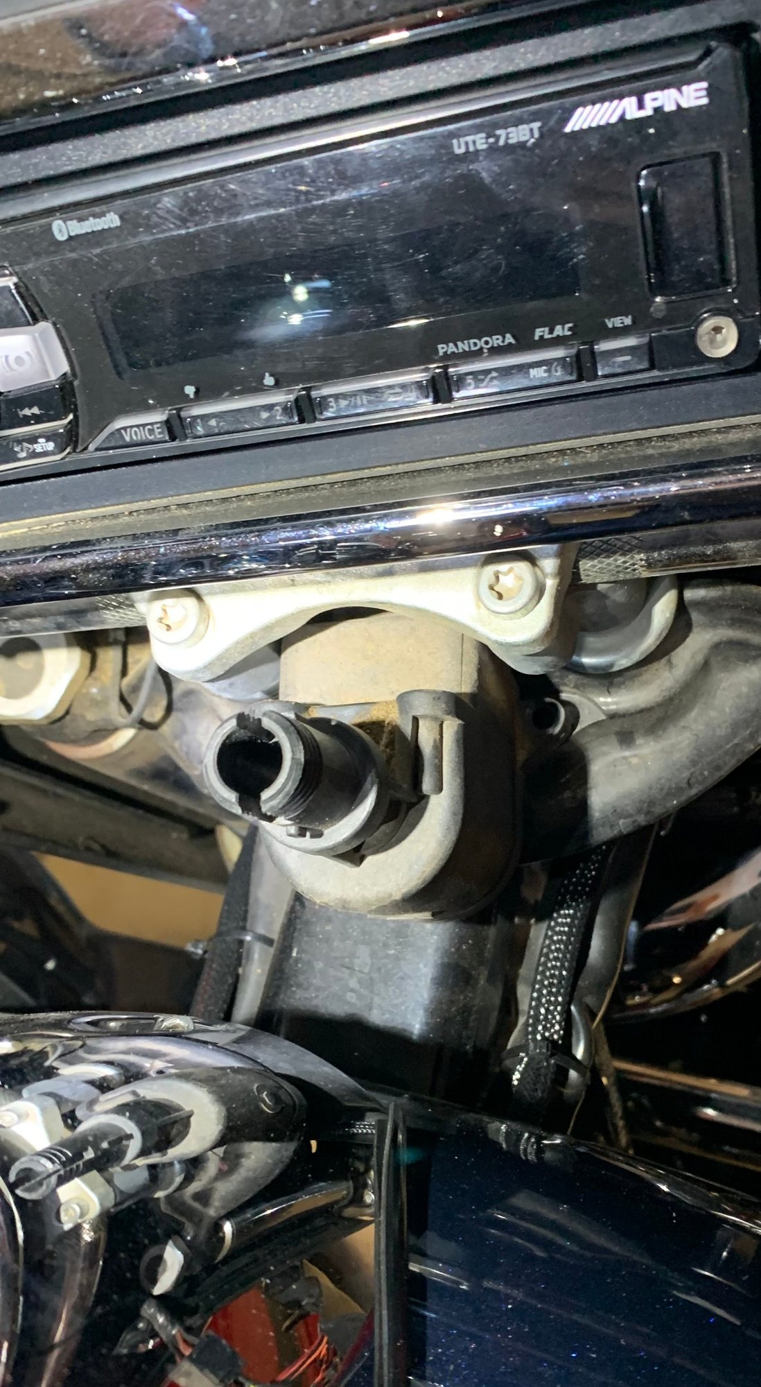

i bought a new switch. Problem now is I can’tremove the old one. Appears the handle bar clamp
is in the way

i bought a new switch. Problem now is I can’tremove the old one. Appears the handle bar clamp is in the way
@Top6222 Loosen the bolts for the lower handlebar clamps and that should give you enough room to flex the bars in the bushings.
Maybe read this thread. You also may need another specialty tool.
