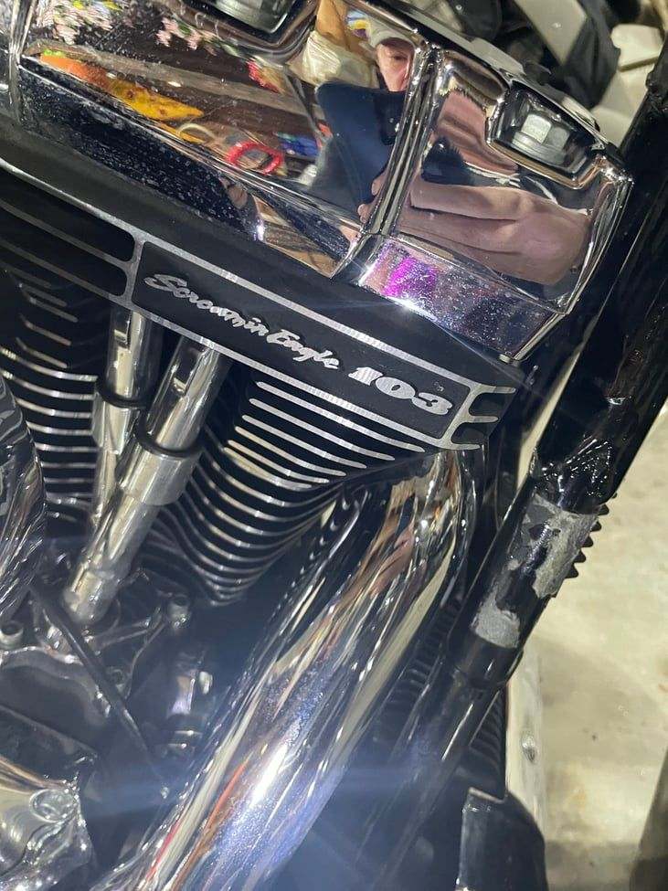

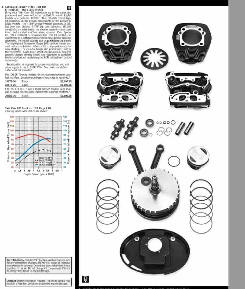

This is me..

Nice....!
But then again, I have the mod sickness...

Well you didn't say it had 103 heads on it... Only SE..
