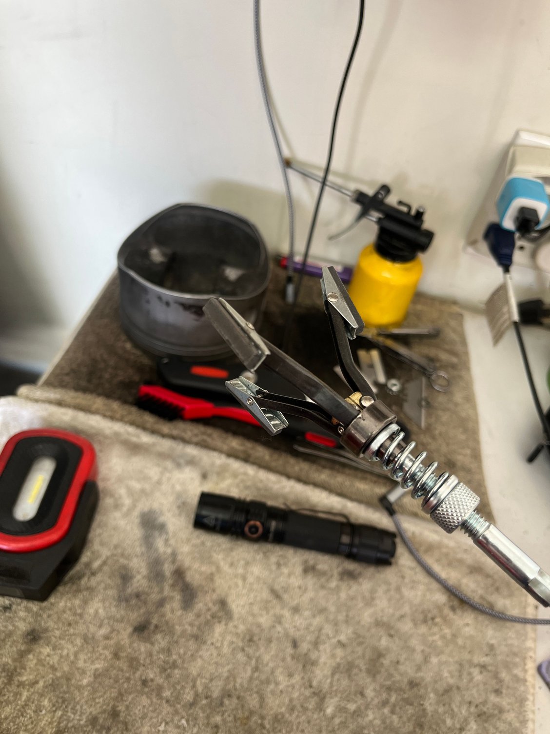

I'm going to hit the inside of the grip with a brake hone. That will either fix the problem or destroy the grip. Stay tuned, I ordered a new hone for this since I can't find my old one.

The brake hone worked like a champ, back to normal and problem solved.
For those of you that might not know what a brake hone is, here's a picture.
