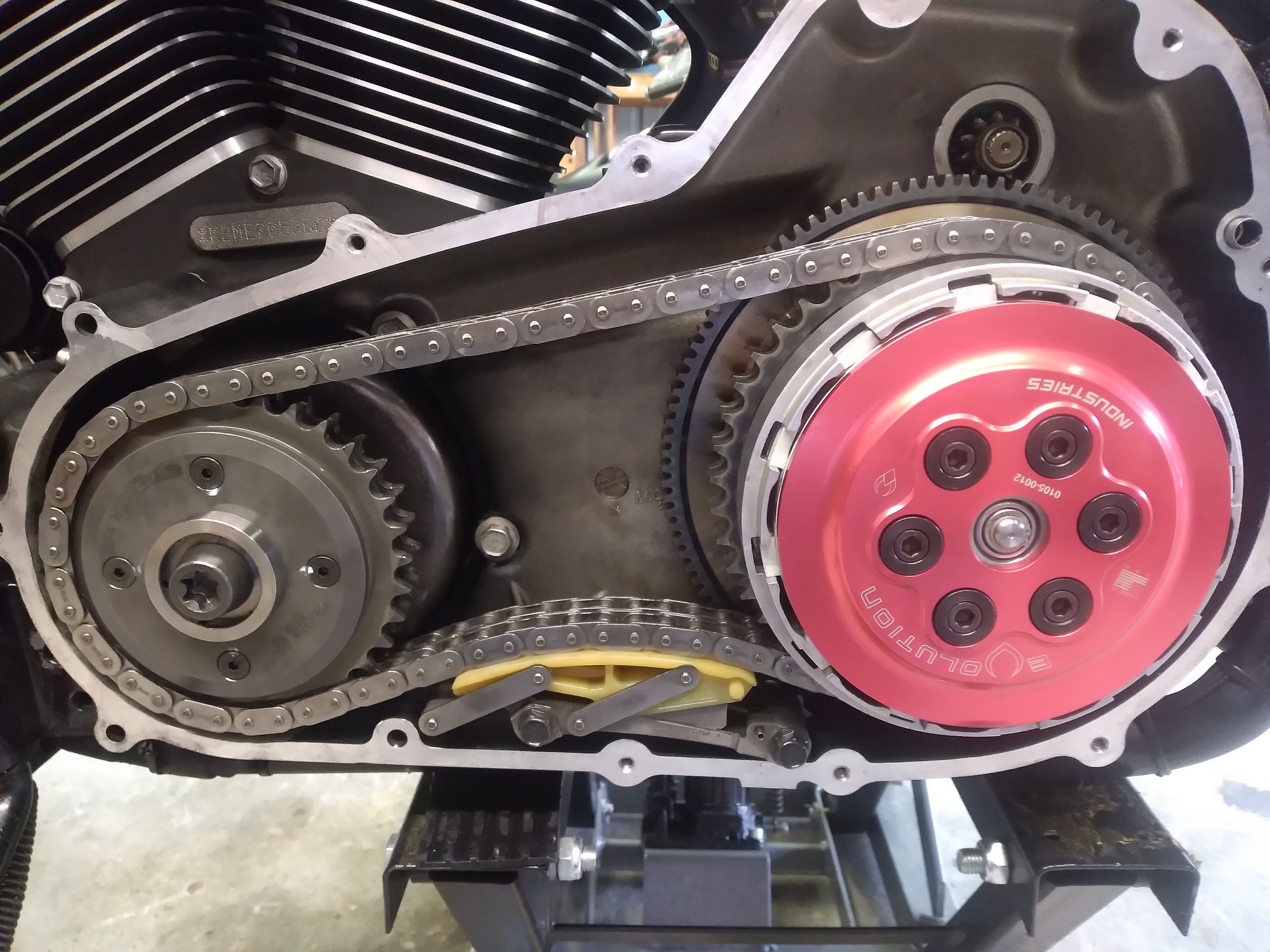

Cool Chain Tensioner ....
As just a suggestion ...when running the stock S/E compensator (with the stock chain tensioner) ...then start to experience primary noise ...we have found that the chain tensioner is the problem ..
It is not tightening the chain as design ...the slack in the chain(chain stretch from new) is what is wearing out the compensator ...YOU NEED TO MANUALLY ADJUST THE CHAIN ...this is causing the compensator to rock back and fourth too much ...then with the load of the bike and riders , causes the comp to wear prematurely...
We have found that the stock adjuster will not auto ratchet up ...(contrary to popular belief that the tensioner is tightening too much)
To TEST . remove primary cover and run with chain open ...stop motor ....then TAP THE ADJUSTER UP WITH PUNCH AND HAMMER(one notch at a time) ...then retest
hope this helps ...it has here ...
FYI ...we also run the M O W motorsprocket too ...and it is very sensitive to chain alignment /adjustment

What year tensioner are you talking about .. The first ones 06/07 had this problem. It was fixed in a later rev.
