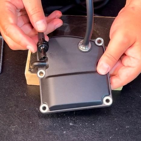

I just ordered one way valve from Amazon that I used before and proven to be effective. I also wonder if I really want to install filter on top as I will install one way valve almost on really top of the hose and expect only air coming out anyway. I plan to combine this with 7/32” ID hose for clean look as I feel hose like that can flow all the air in the world that will be created by this engine internal pressure. I have hard time to justify 350$ for something I can achieve after spending 30$ on. Sure it wont be as pretty as Trask but I will make it look pretty. Plan to document whole procedure on my YT channel just waiting for parts.

Just got done with venting my engine via trans cover. Super easy and cheap mod. You dont need to spend $350 to do it. #JustRideThatThing
